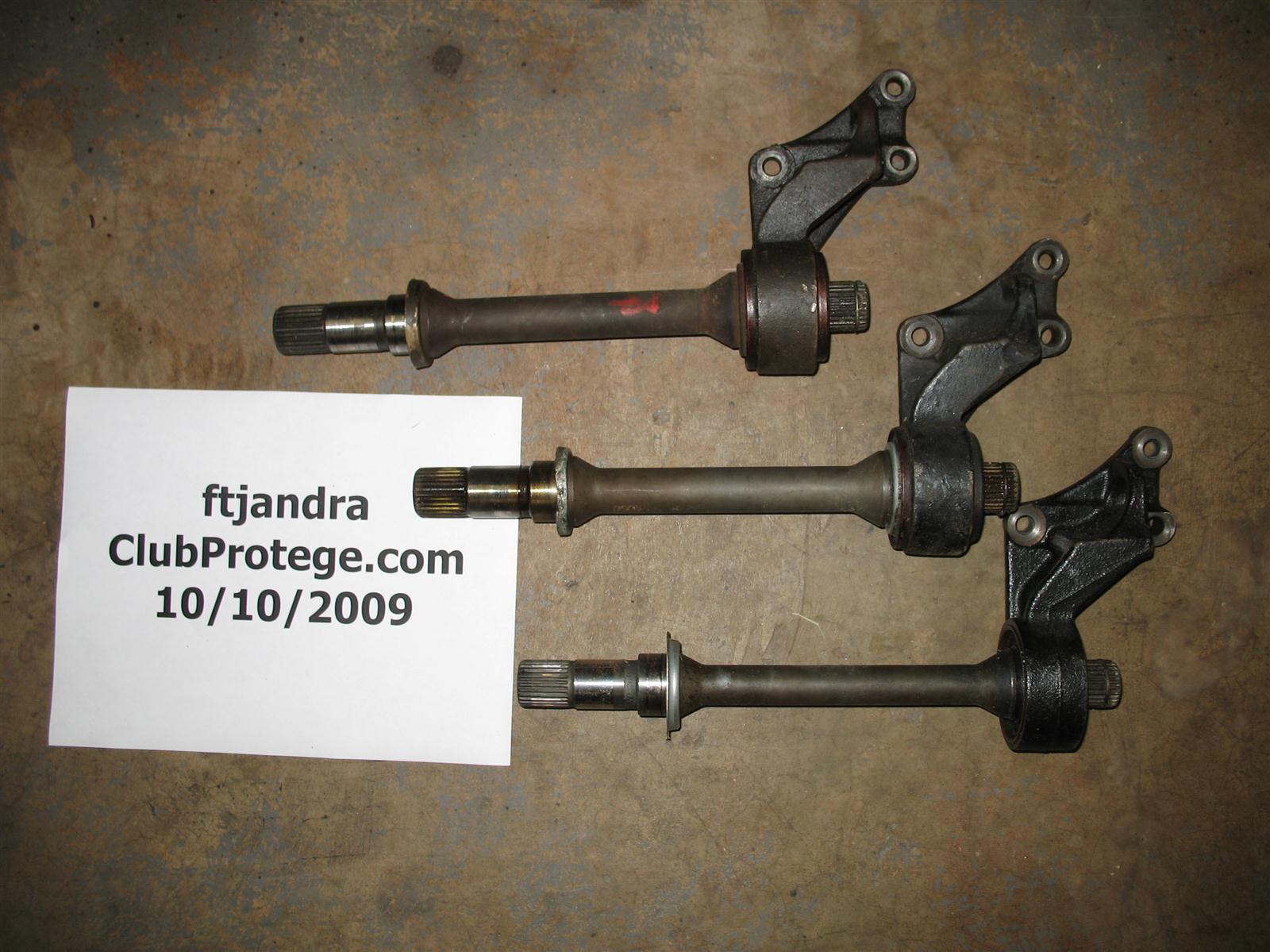

A pic of what? The intermediate shaft looks like this. One side goes into the trans and the other attaches to the block.Originally posted by johnMZ24 View Postanyone with a pic?

Yes, they are two separate parts. And, I doubt a parts store would have the intermediate shaft. The intermediate shaft pretty much lasts forever. The only way for it to go bad would be the bearing, but it's replaceable. Or, if it breaks in half...
