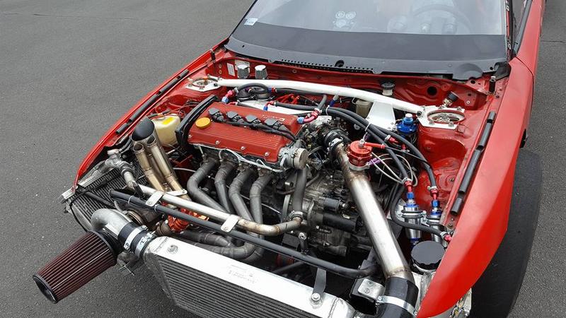

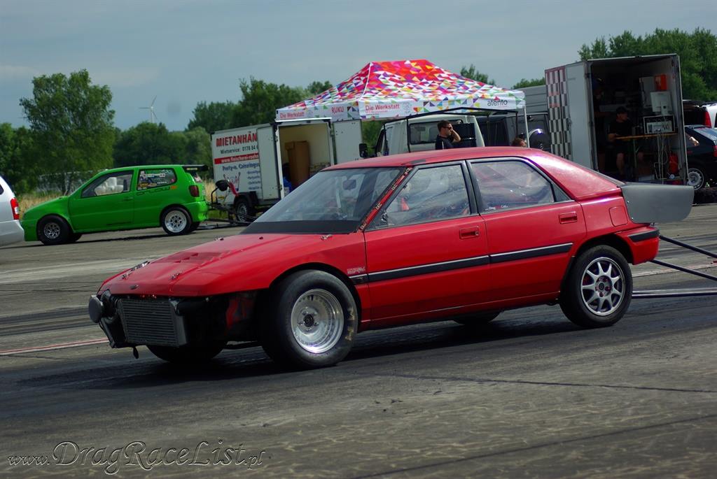

Car is with me for a long, long time. It started as 1.6 with just power steering. Plan was to make OEM look classic with all japan extrass. 1.6 wasn't enough so I swapped engine to 1.8 and .... surprisingly after a year or so lack of power sickness returned. For some time I was going N/A route (head swap, polishing, adjustable cam gears etc.) and ended up realizing that: go BIG or go home :D. and then fun begun and car started to be less street and more DRAG..
enough for words time for some specs and pictures:
Power:
In theory new engine should have: 128KM 157NM
28.08.2009: 116 HP/148 NM - Power after swap from 1.6 to 1.8 DOHC
17.09.2011: 130,9 HP/167 NM - Pacesetter 4-1 exh. header, adj. wheel on intake cam -5° , CAI, MAF->MAP convercion, FI (Fuel implant mode in DET3 piggiback)
28.07.2012: 137,5 HP/164 NM - BP4W head, Throttle body bored out to 60mm, PTFe instead of normal gaskets on intake, adjustable cam wheels set back to 0, removed VICS
27.09.2012: 230 HP/241 NM - First dyno after turbocharging :0,45-0,5 bar. boost was controlled only by WG (now MBC/EBC etc.)
02.04.2013:230 HP/ 270 NM - 0,5 bar, EBC (test 2 - boost controlled only by WG, test 4 - EBC)
02.09.2013: 260,9KM 304NM - Test1- EBC set to 0,5 bar, Test2 – 4th gear 0,7->0,85 bar, Test3 – 5th gear 0,7->1,2 bar on revlimit, Test4 – 5th gear and retarding ignitron instead of advancing + fuel cut…
07.11.2013: 291,6KM 296NM - Test1 - 0,7b/4000 ->1.3b/7500, Test2 - 0,7b/4000 -> 1.1b/7500 (ignition advanced by 2 degrees)
18.09.2014 - 359KM i 367NM - Test 1 - 1 bar, Test 2 - 1,5 bar
14.07.2015: 397KM i 368NM at 1.5-1.6 bar
Now: ???? but should be 500++

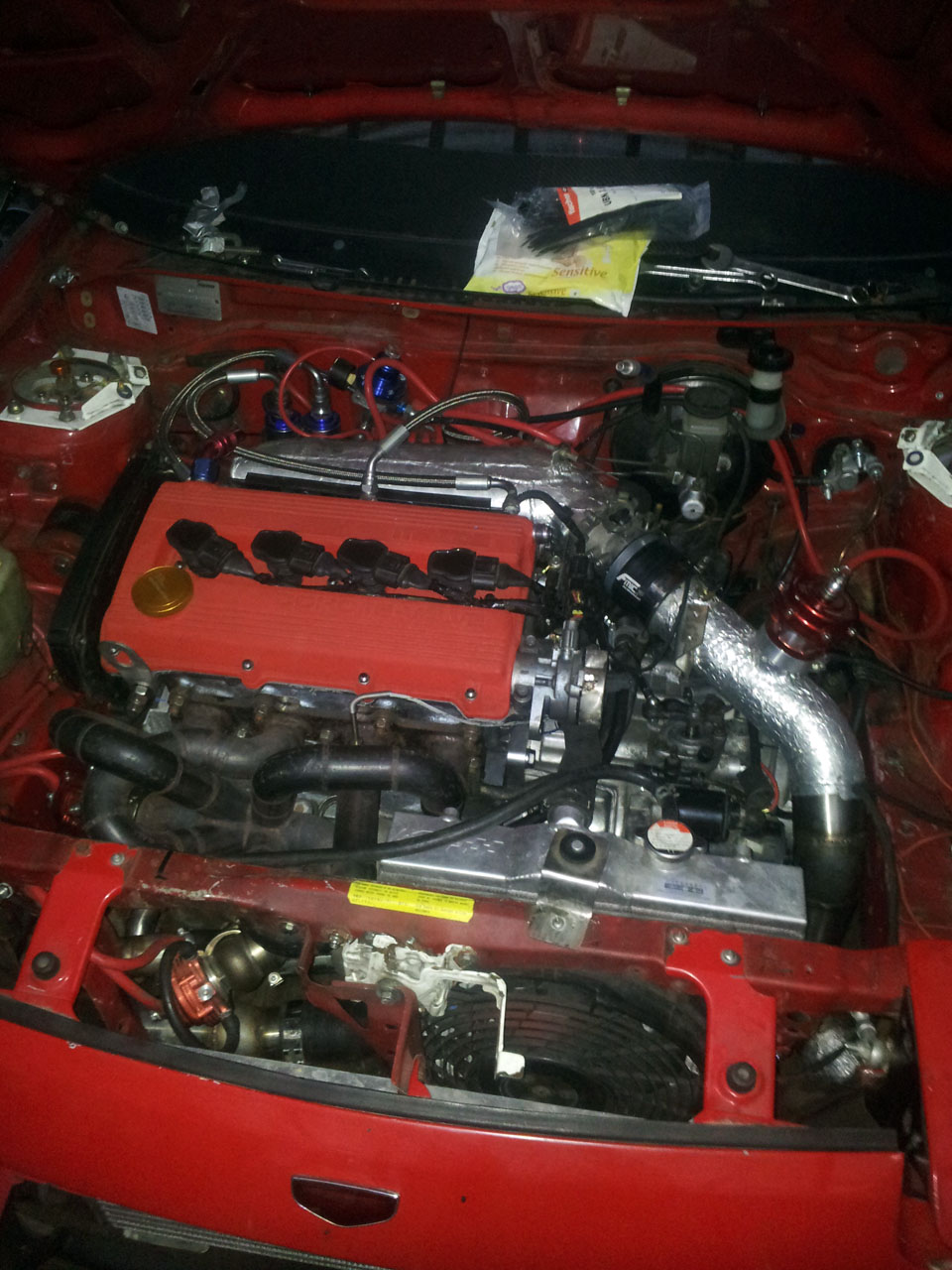

ENGINE:
– BP 1.8 DOHC (swapped by Waldii)
– Forged Wiseco 84mm pistons
– Forged Manley rods
– BP4W head
– Home made head and valve work (polishing exhaust ports, intake ports were just grinded, polishing intake & exhaust valves, matching gasket with exhaust & intake ports)
– SOB->SUB conversion
– Supertech +1mm HiFlow Intake valves
– Supertech +1mm Inocel Exhaust valves
– Supertech Double Valve Springs (74lbs) & Titanium Retainers
– Supertech Valve seals
– Gates Racing Timing Belt
– Main & Head ARP studs
– Mazda GTR Main & Rod bearings
– Cometic Head Gasket
– Mazda GTR Water Pump
– Boundary Engineering Oil Pump Stage 2+
– AN10 engine breathers
– Rev. limiter set to 9300
– Adjustable Cam Wheels
– 2 Oil Catch Tanks with 35mm filter

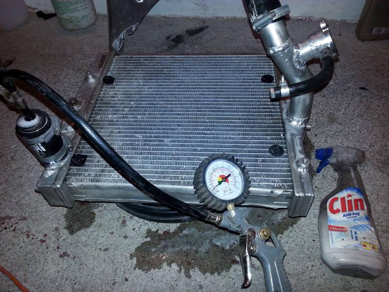

– 50mm Koyo aluminium radiator from Civic
– Alternator, crank & water pump pulleys Rom Miata (Conversion to v ribbed belt)

FUEL SYSTEM:
– 12liter custom made fuel tank located in front left fender
– Sytec external Fuel Pressure Regulator
– Bosch 2200cc
– 2xBosch 044
– Ethanol (E80-90)
– Nitrous
INTAKE:

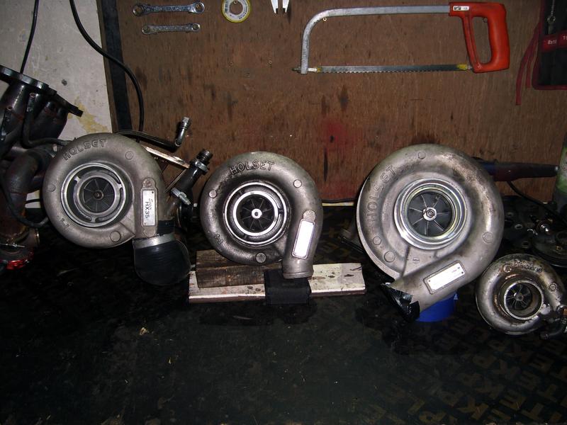

– HX52
– BOV Tial 50mm
– SS net instead of air filter

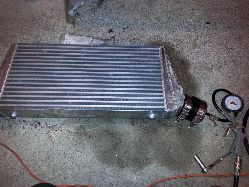

– IC 600x300x76
– SS 3” piping
– Custom Intake Manifold by MK2 VRT
– VR Throttle body
– OBX thermal intake manifold gasket

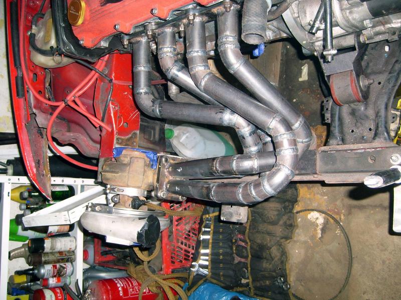

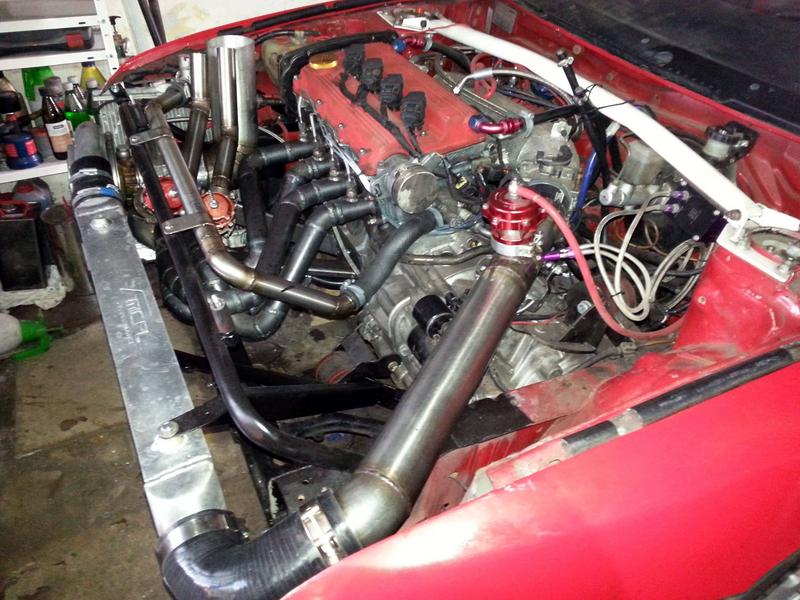

EHXHAUST:
– Home made Ram horn manifold
– 4xEGT probes

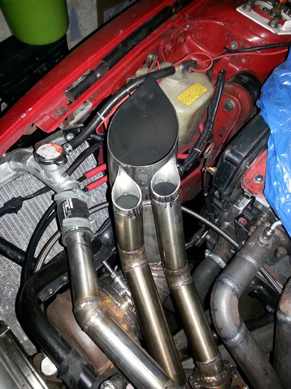

– 2x WG TIAL 38mm
– 2x Screamer pipes going through hood
– 3” Exhaust pipe going through hood
ELECTRONICS:
– Ecumaster EMU
– 60-2 trigger
– VR sensor on crank
– Mazda Hall sensor for sync.
– COPs with VW Coils
– AG Stepper motor with peak gauges: oil temperature & pressure
– Tablet showing engine vitals thanks to Ecumaster Bluetooth module connected to EMU
– Shift Light
– Flat Shift

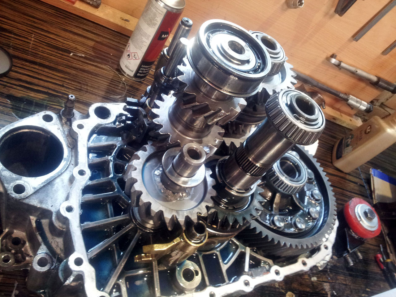

– 02m VW gearbox
– bester lock

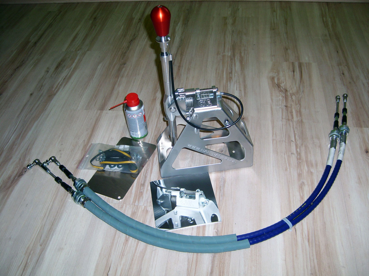

– Don Octane 4 gear dog kit (thanks to MK2 VRT)
– CAE shifter (thanks to MK2 VRT)

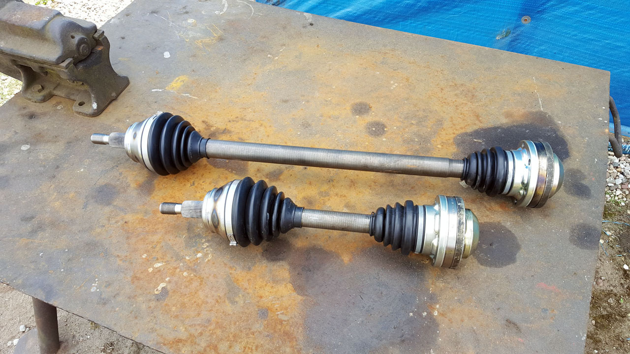

– Big VW inner CV joints
– Big VW outer CV joints
– Custom axles
– Custom hubs

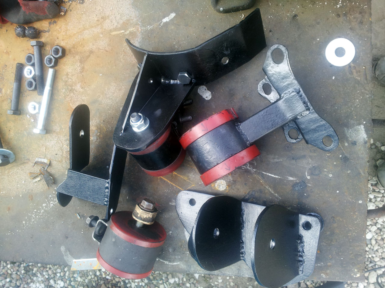

– Polyurethane bushings
– Upper front and rear strut bars powder coated white
– Polyurethane engine & gearbox bushings

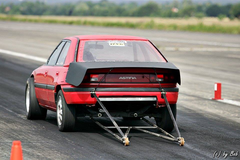

WEIGHT: 880 kg

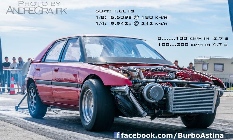

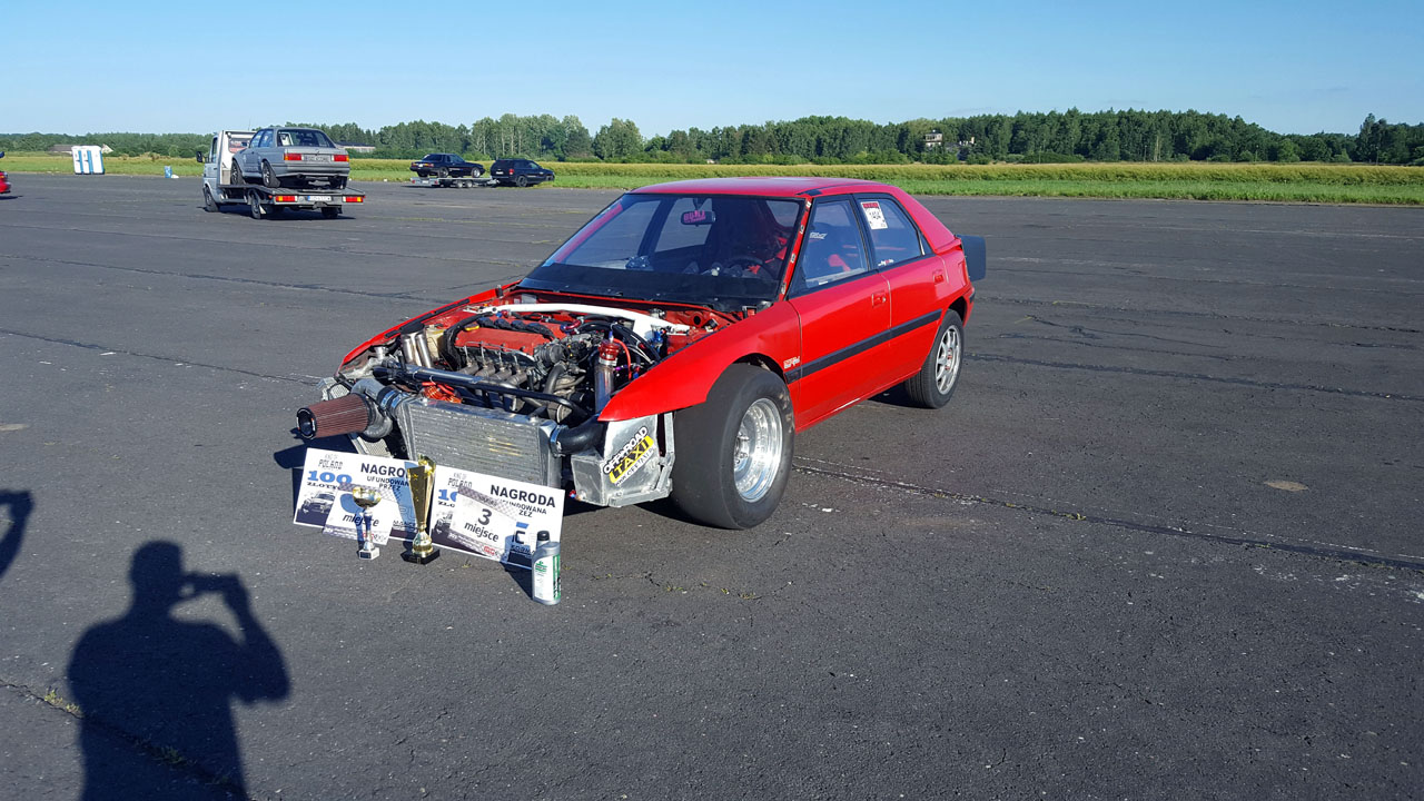

Best ET on 1/4 mile: 9.942s @ 242 km/h (60ft: 1.601s, 1/8: 6,6s) - 16.09.2017
--->Video from this pass<---
Exhaust tips:

HX35 Vs HX40 Vs HX52 Vs Garrett GT20:

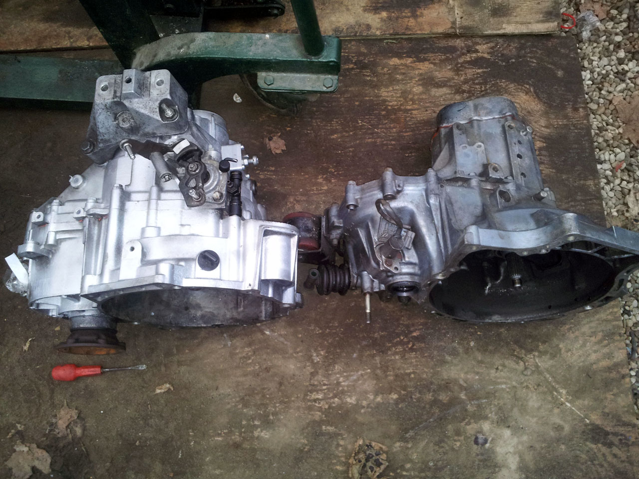

VW 02m Vs Mazda G-series (check out difference between size of diffs :O):
Custom mountings:
Custom axles with big inner and outer VW cv joints:

CAE Ultra Shifter:
"Straight" gears for new gearbox (yes it's only 4 gears now

CAE Ultra Shifter:
