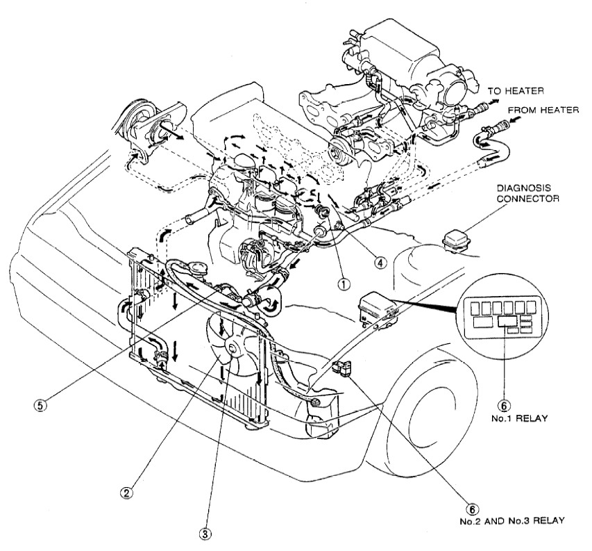

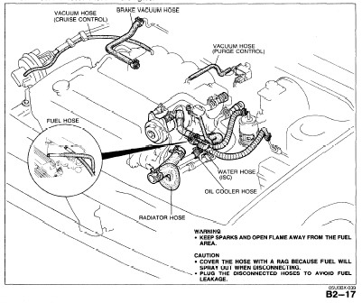

    i need a diagram of where do all the hoses off the Thorrtle body go, i disconected em an cats remeber were, i believe theres 2 on the bottom of the Throtle body that i need toi know where they hook up, thanx

    here you are Is it enough ?
      coolant hoses

            they aren't necessary...they are for the IAc valve, they keep the tb warm so it idles better. Lots of ppl remove that crap b/c it heats up the incoming air which means less power.
