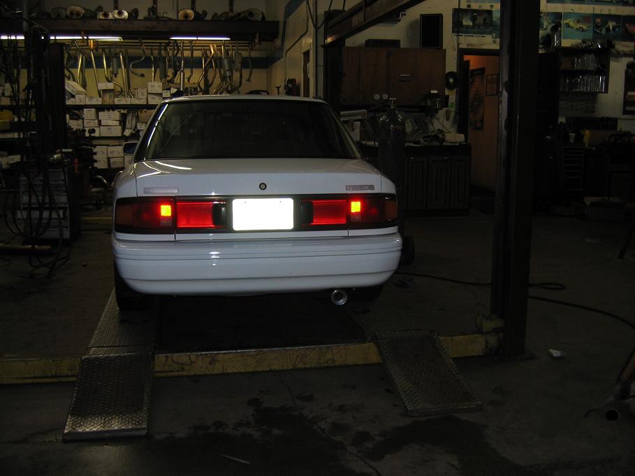

            Well, I took it to the closest place I could find, that had also done work on my brother's MX-6 - Midas.
            I walk in there, it's a cold and rainy day, there's no customers, I look in the shop and there's like 4 guys standing there doing nothing. I basically made thier day.
            The manager comes to the counter, and I tell him that I need some custom exhaust work done. He asks what, and I tell him that I tried to make the exhaust my self and it didn't work out too well. He takes my key and puts the car on a lift...as the car goes up the other guys are looking under it with faces like "What the hell happened?!". The main guy motioned me to come out. I explained everything I could, exactly how I wanted it done, and that I wanted a converter I had installed. Well, evidently it's against the law for them to install used converters. So that cost me $129 for a highflow converter they had on hand. But hey, it got done.
            Basically they fixed the downpipe back. New flange at the downpipe, a pipe back to the converter, another back to my HKS section...had them redo the one weld I did on the HKS, then a new flange after the HKS, pipe to the muffler, and hangers where needed. It came out pretty good and looks very strong. A job well done.
            Well, the car is still loud, but now it's just the exhaust noise and not leaks and rattles, so it's a vast improvement. The labor came to $178(close to what Redfox paid!), so the total cost was $334 or so. Which sounds like a lot, but if you look at it, the Powerseries catback is $349 plus shipping, and then I'd still have to get a converter made for it, so it would have been $500+. I think I did the right thing.
            However, I've decided that my Magnaflow has got to go. It's too free-flowing which makes it loud. When I stand next to the car, you can here where the exhaust is loud and it's at the magnaflow.
            So...I need a muffler that's 2.5" but quiets the car down as much as possible. Any ideas?
