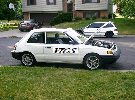

                      VROOM VICS!
                      we need VICS stickers....

                          Originally posted by Dixie94Pro View Post
                          VROOM VICS!
                          :rofl:

                              Nice how dixie posted VICS on my car.... In that pic dixie it doesn't have VICS anymore!!!
