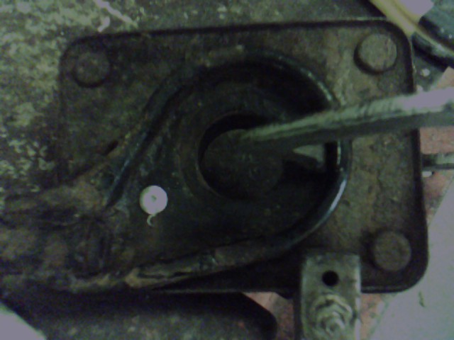

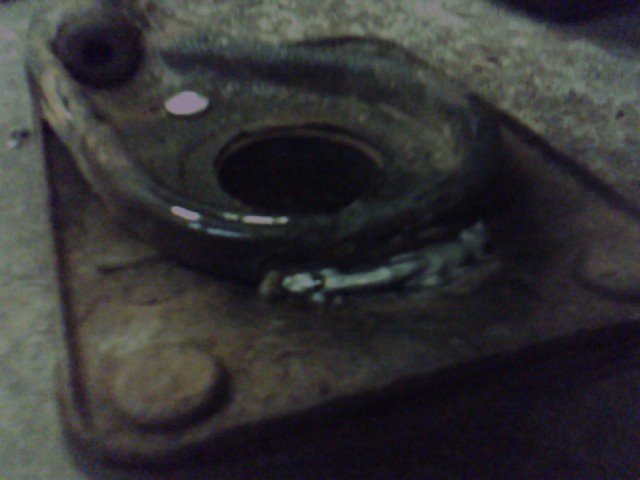

            This happend to me to if you take out your center console and you will see the part that has fallen through. it's a circle in the middle of a plate that is bolted in. what I did was drop the exhaust took down the hole linkage and put a weld on the back and a rivit to hold it up. sorry about the pics they were taken with my phone.
