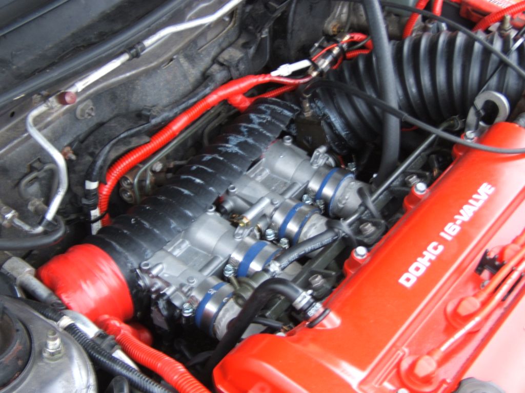

    I used to run them in mine before I went turbo. The TB is off of a GXR-1000 and the manifold was a custom-made one.

    yes but you need to build a properly sized plenum with velocity stacks.
    -jon

    it has been done a lot on the miata/mx5 rwd platform, is see no reason why a fwd BP motor cannot, the big issue is cost: manifold, standalone ecu, throttle bodies being the biggest cost + a lot of extras (injectors, tuning, fuel pump etc).
    on a bang for your buck ratio BP turbo is the most cost effective way of getting more power and easily.
    i am in the process of putting together a twin sidedraft dellorto setup for a BP fwd motor im having a job getting the manifold cheaply ( i know of 3-4 sources for the weber/dellorto manifold ) - by the way the miata inlet manifold for 1.8 bp engine is interchangebale with the fwd familia/protege/323 item - which means if you got a manifold also you would be able to buy weber/dellorto throttle bodies for a cheaper outlay ( but still very expensive )
    plz note later miata BP inlet stud pattern changes you want the early ones (1990-1997 port design)
    see my ride for pics of 2 of the possible manifold solutions, 1 of them is avail from http://www.piercemanifolds.com/ K694 40 DCOE X2 99003.694 it is incorrectly listed as for e3/e5 series engines
