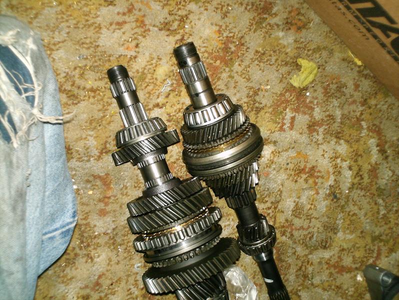

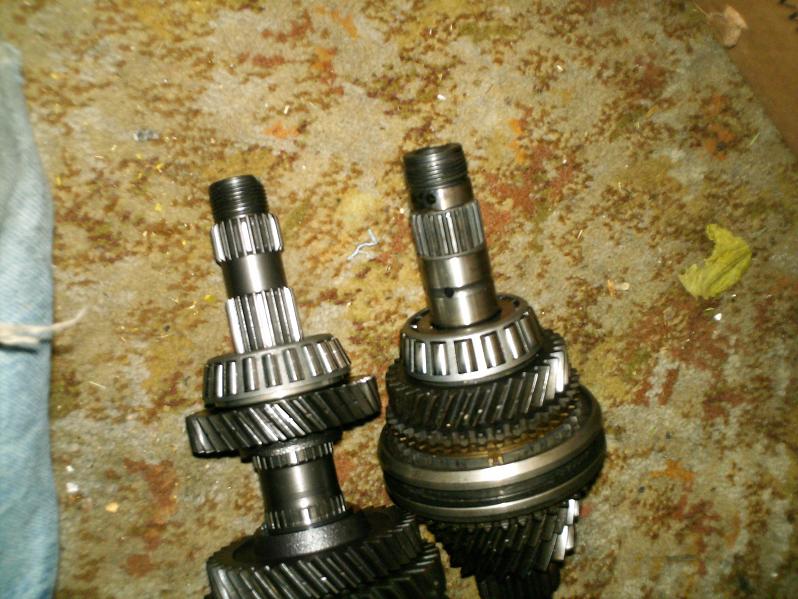

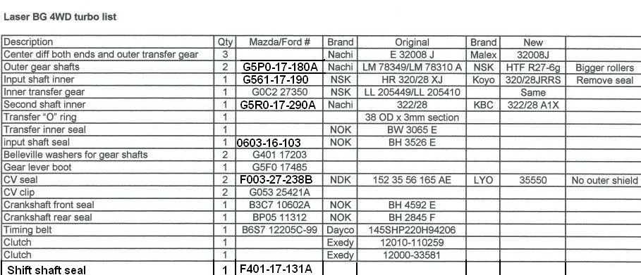

I finally found the # for the inputshaft bearing, but happen to have lost all of the others
can anyone help me so i can compile a list.
primary inputshaft taper bearing: NSK HR 320/28XJ
Differential bearing NTN 4T 32008X(bg old/superceeded by BJ part forgot that number
secondary shaft (inputside) NACHI 322/28A1
primary/secondary end case bearings NACHI LM78310A
help ON THE msp LSD bearing part number from mazda of: G5R0-27-350B Looking for the # on the bearing race.
