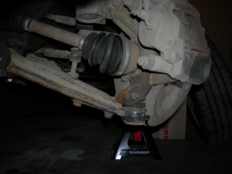

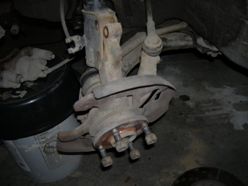

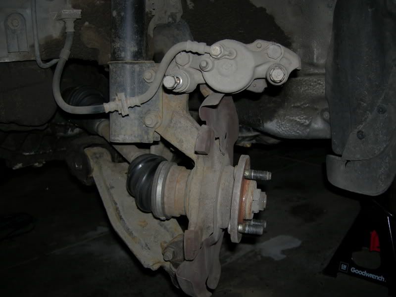

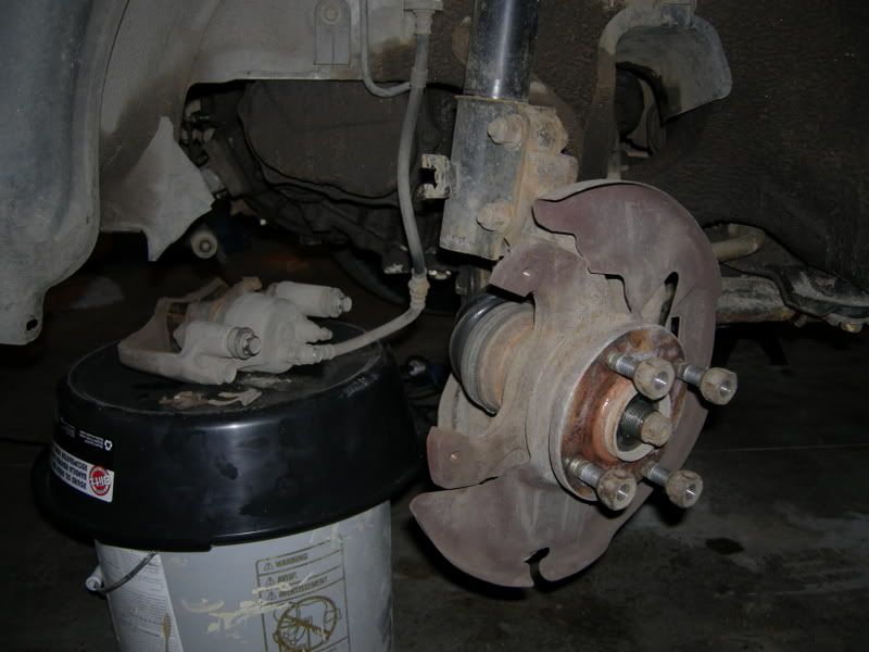

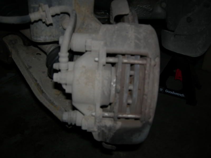

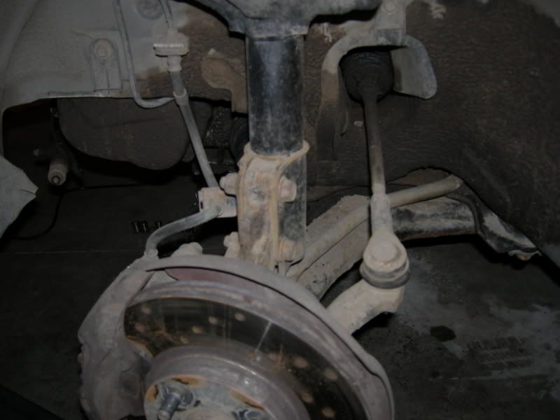

            Here's some pics for you. Its as far as I got before I had to come to work. crappy work...coulda had the trans all but out if not for you!
            The hub assembly
            there's the ball joint bolts, didn't have to take them off
            just 2 bolts on the caliper
            easy as cake to remove, and my disc came off nicely, not rusted on
            here's the hub nut, 32mm if you don't know, used a 1/2" breaker bar with a 4ft cheater bar, and it came off.
            use a bucket to support the caliper, and crank the wheel hard left, and remove the strut bolts
            now crank the wheel hard right, it should push the hub off the axle, assuming its not rusted heavy on.
            get the strut off the hub. now you should be able to pull on the assembly down and to the side, might have to play with steering angle, but it should come out without removing the ball joint or steering arm!
