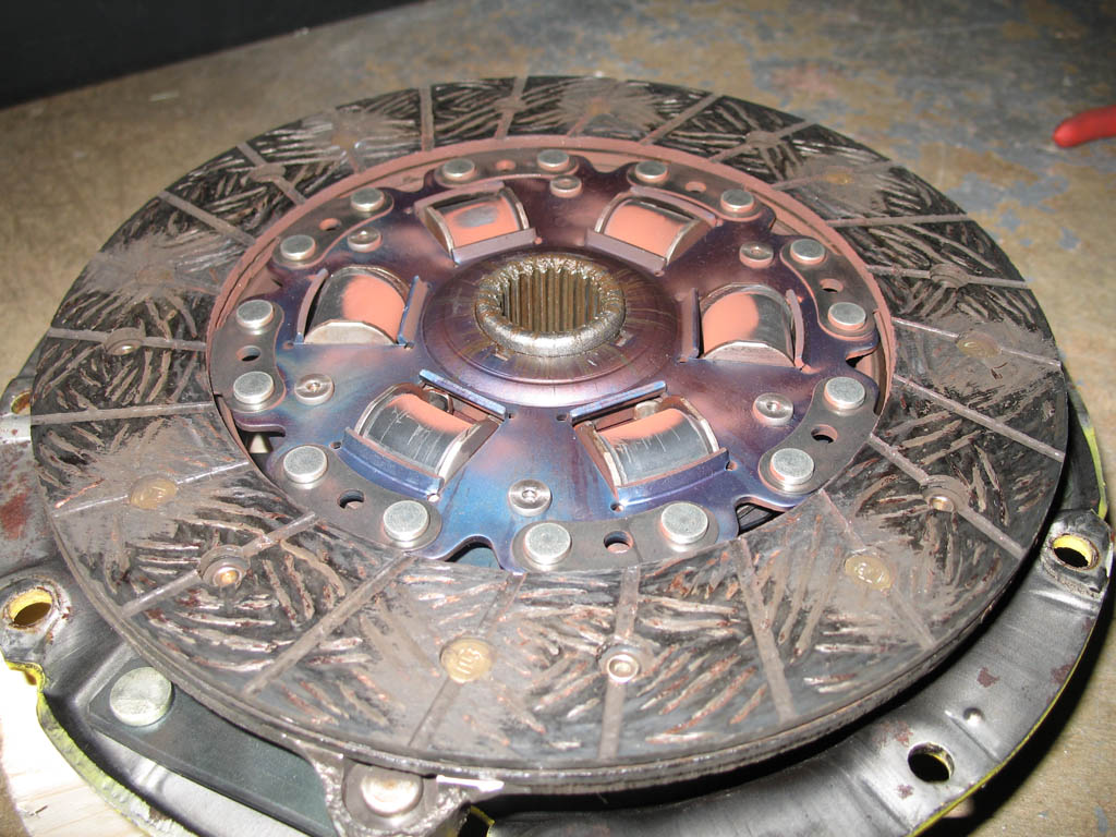

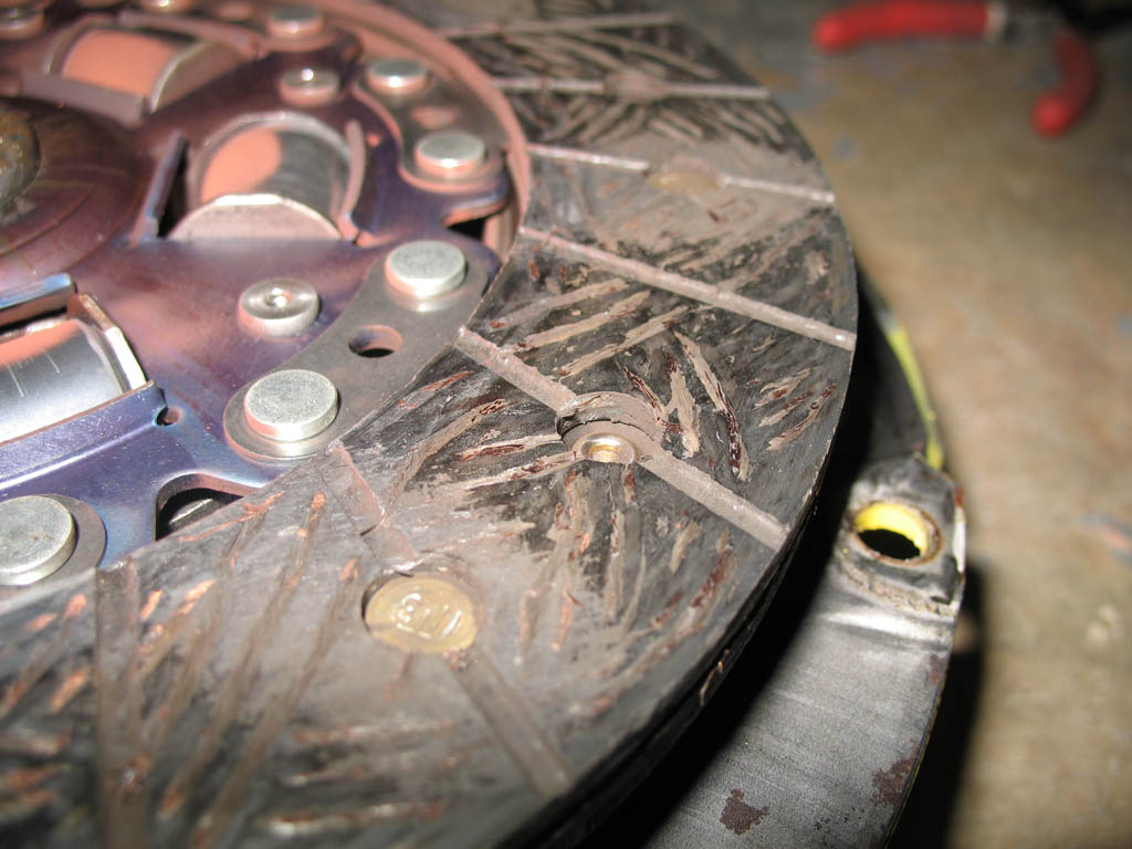

    Is this clutch disc glazed or just not worn in completely yet (~2k miles)? I haven't experienced any slipping. To me it looks like the area where the rivets are is not making contact with the flywheel/pressure plate *yet*. The other side looks identical, just with the opposite rivets. The area in between the rivets is a little shiny and somewhat smooth, but nowhere close to a mirror finish.
    Ok, to put back in?

      I would think it's ok as long as it's not slipping. Wait for someone else to reply though. I don't have very much experience changing clutches.

        why'd you pull the clutch out 2k miles later anyways?

          yeah my used GTX unit from a member's swap looked like that, and its still going 1 year later, with lots of hard driving.
          the only concern i would check for is any signs of overheating
            Looks ok to me. Seems to have some even more holding power in store.

              Looks fine to me too. In fact, the laws of physics would say, the less material that is being touched by the pressure plate and flywheel, the greater the force those areas are seeing. That's why most race clutches are puck style.
                The tranny blew and I figured I'd take a look and see how the clutch is holding up.
                What are the signs of overheating? I didn't notice any discoloration on the flywheel or pressure plate.

                Thanks for all the info guys, I guess the disc is going back in.

                          pitting of the metal surfaces (like the edges of a piece of metal after cutting it with a torch) or in extreme cases small fractures in the metal surface, all of which you would see easily on the metal were the clutch material and the hub meet.
                            on 2nd look (on my home pc cuz my work one is BS) that disc looks fine for a used disc. the slight divets seem to follow the rivet heads only , so the valleys are probably from the manufacturing process.
