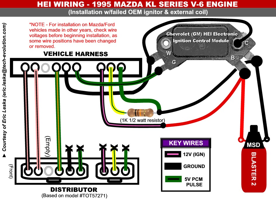

    ok ive been looking for doing the HEI mod and i cant seem to find any good diagram... i find some but whitch one is the good one? please help...
    BTW i have a 1994 mx3 with klze engine and k8 disty and k8 ecu... i dont know if it makes a big difference because i know that the wiring is not the same as all the diagrams i find...
    so please any help would be appreciated...

      ok thx but i already looked at that and my wiring is not the same...
        in the 3 pin plug the wires positions are not the same... hte colors are the same but not the positions...
          perhaps this will answer your questions
            thanks man that really helpful thx alot
              is that what you needed?

                pretty much yeah but is there a way i can do it without the external coil? or is it alot better with the external coil? and what kind of external coil exactly do i need?
                  i orderes the MSD blaster coil 3 is that ok? and does it come with the power tower?
                  and i wanted to know where can i get a 1K 1/2 watt resistor?
                    go to radioshack or some place similar for the resistor

                        because my disty's module is fuucked so instead of buying an other disty and it might do the same thing i will do the hei mod because its more reliable...
                          hey guys im doing the hei mod and im referring to the diagram in post #5 and i cant figure out the wiring because in ma 94 mx3 its not the same color and positions... so could someone help me, if someone already did it in there 94 mx3 please help... i can give you the wiring colors and positions if needed...
                          i need it FAST please...
