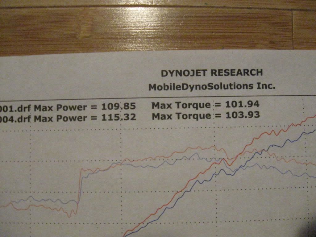

    Before I left for WP I let my tank get really low and then filled up on 93 octane. Before it was my time to dyno I advanced my timing by guesstimate.
    For my first run the operator ran it all the way to 7k and it didn't detonate that I heard at all. Made 109.85whp and 101.94tq but it was a fairly flat curve. On the second run he heard some detonation and pulled the plug, so I bumped the timing back a bit. on the 3rd run he thought he heard a little detonation and cut it off again. I said w/e and bumped it back a tiny bit more and then he ran it for my 4th and final pull to get 115.32whp and 103.93tq. Although I have a bit more up top I don't have much down low. I'm pretty unsatisfied with those numbers considering whats done and shawn put down 119 last year on a stock bp with a catback.

    your motor has seen some better days. you should see what my dyno chart NA looked like next to yours---- do a search
      that motor has damn good compression, runs mint, has perfect vacuum and doesn't burn any oil. plus it has like 80k on it.

        it doesn't make sense that Shawn's dyno pull last year netted him more power with less mods than Steven's this year... even taking different dyno's into consideration that sounds weird. Not that I was there for Shawn's run last year but the numbers don't make a whole lot of sense.
        '12 Ford Focus SEL
          sorry dude, but something is not right
            I see no a/f ratio stats... I am thinking you need tuning..
              It's stock ECU, how am I supposed to tune? The Vaf is tuned to where it is supposed to be at. I'm not going to run a piggyback. I may get an MS just to see what I can squeeze out of a NA bp without internal work. And I guess his o2 wasn't working right or something.

                    still looking for my 119 pull dyno chart, but here is the video of the 323 doing 114 on a BP with a catback, filter, and MSD box.
                    NOTE: I made 114 with 99 tq
                    you made 115 with 104tq
                    you need tuning, start by yanking out that A-code for a U or B code, then tune again with that vaf open, look what it did for jinx
                      115whp sounds about right for a car that doesn't have a proper dyno tune! if you had of adjusted the timing with a gun and adjusted the vaf as well...you could have pulled an easy 5-7whp right there imo.

                            Brand of dyno can make a difference too. The last 3 shops I've worked at had dyno's and they were all a little different.
                            If it makes you feel better my festiva with a bp (supposedly $2k internally from previous owner), cam swap, toda cam gears, pacesetter header and 2.25 inch exhaust, and CAI made 108whp/111wtq.
