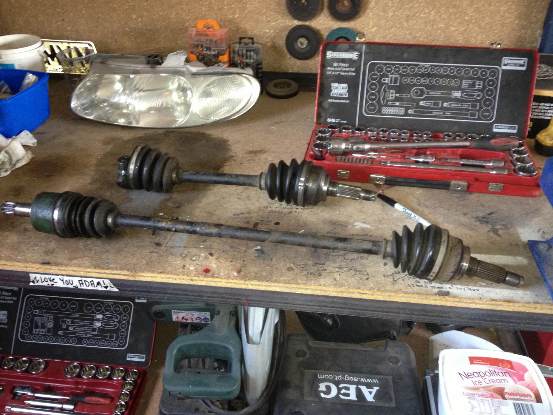

            What is the intermediate shaft? And i basically have one cv shaft that about 400mm long going to the pasenger side wheel and then the one goin to the drivers side is about double that.. My axles come straight out of the gear box going directly to the wheel hubs. Im guessing the intermediate shaft is the straight shaft that comes out of the gearbox and goes through a bearing of somesort that is attached to the back of the motor?? And then that attached to the axle??? If it is, i actually dont have that.. I just have two stright axles comin out of the gear box going directly to the wheel hubs. I dont have that extra bit to make the axles equal length or atleast very close to it. Thats why i was asking about that intermidate shaft (if what i guessed is correct) cuz i wanna make my axles close to the same length cuz like i said one axle is about twice as long as the other..

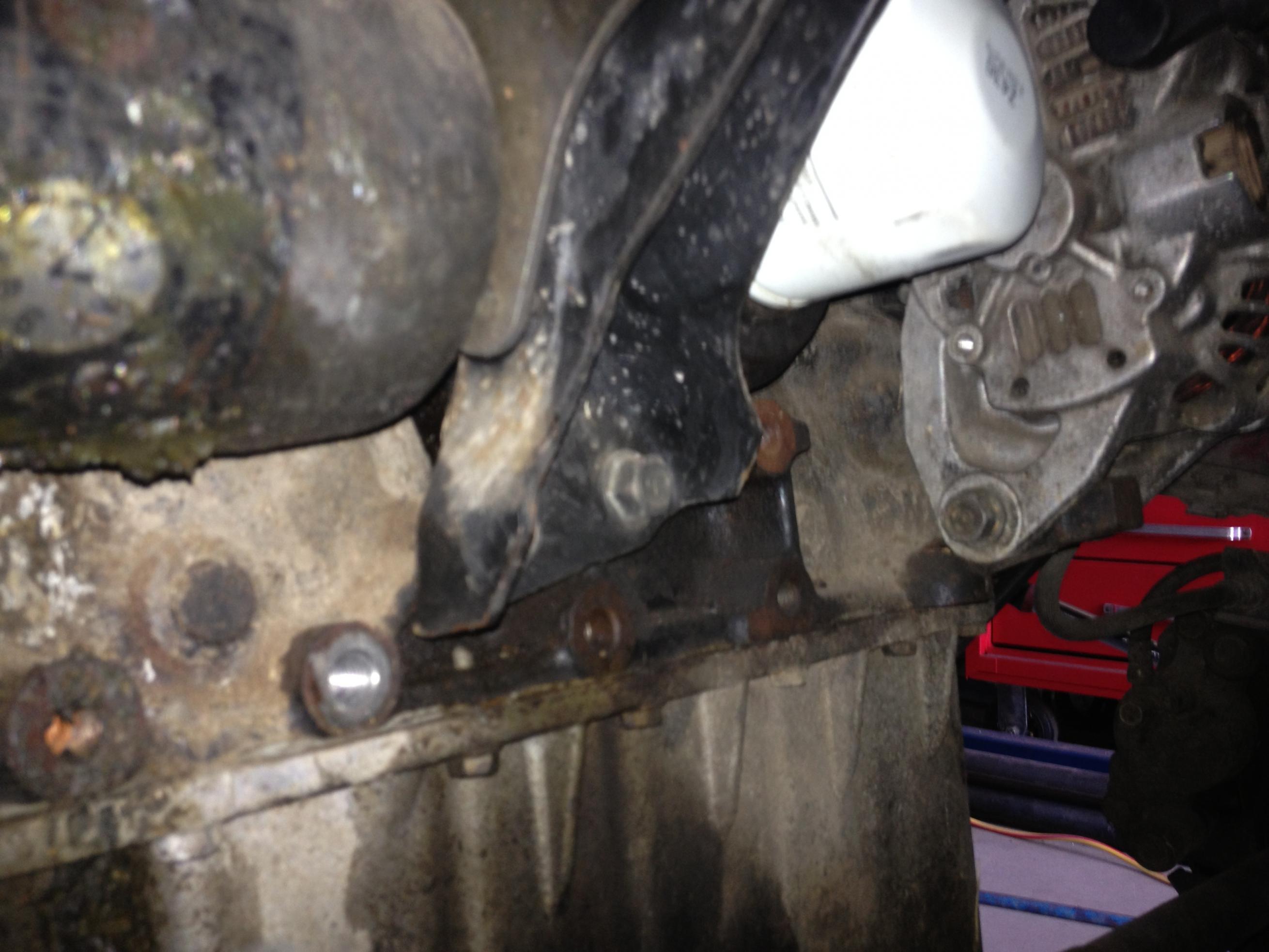

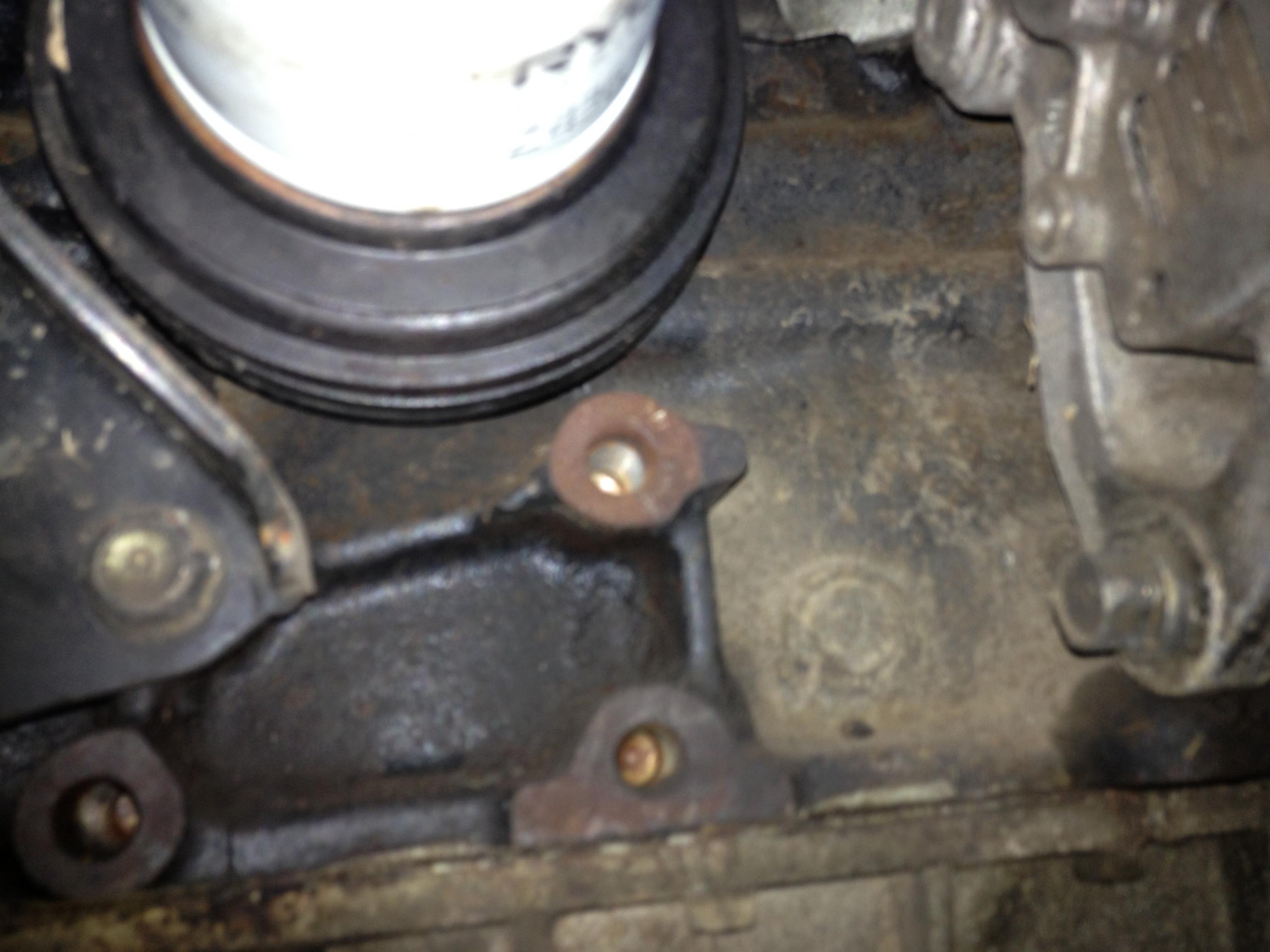

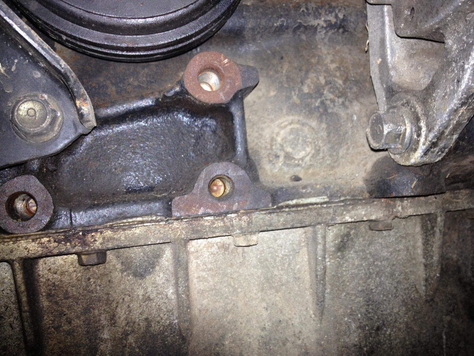

              I wanna see pix. Wondering if this is some sorta EDM thing we didn't get in the states. Does your block have the 3 bolt holes needed to locate the intermediate shaft bearing? If so then there's your fix.
                Hi guys. Took some pics. I held my phone randomly behind the engine block to take some pics. There are 3 bolt holes there so im guessing theres my fix. Where can i get an intermediate shaft and the bearing/bracket etc?? Any aftermarket??

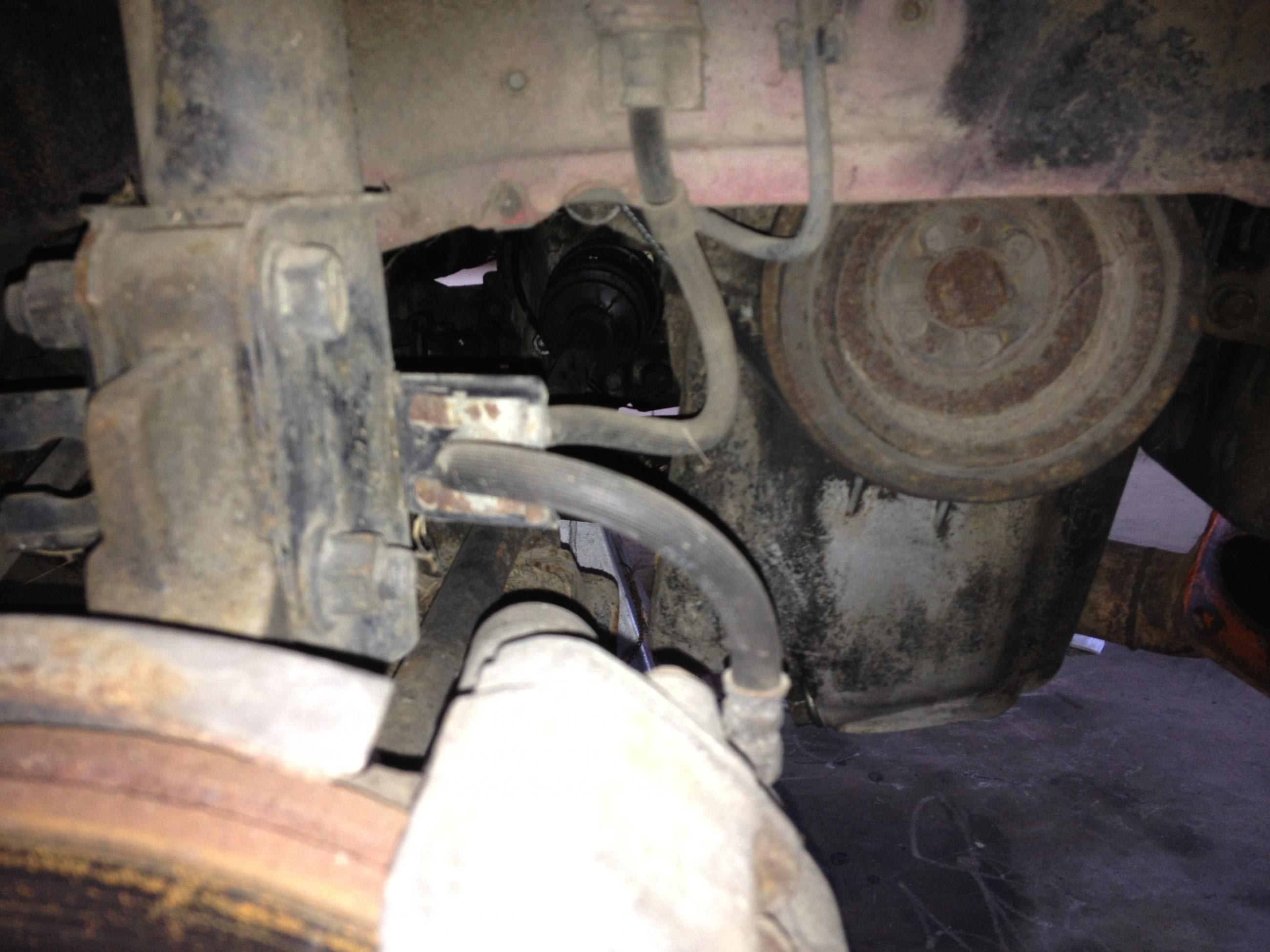

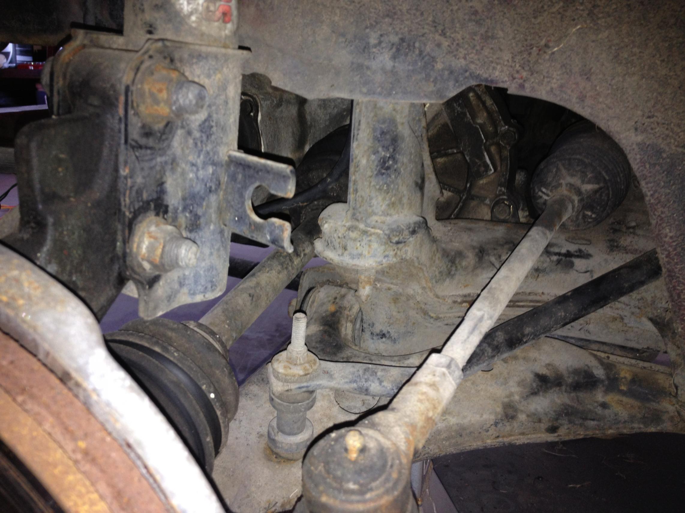

                    And here they are very dirty under here thats for sure. i bought this car thinking it would be a quick fix but so far its only pulled money and a lot of time out of my pockets lol. The guy had flogged it, and since ive pulled the axles out ive noticed my left hand front brake is leaking fluid slowly, very slowly. But anyway this is what mine looks like.

                      so, is this thing running an F-series box then? I've never seen a G-series with unequal length axles.
                      03 Accord DX: K24/5MT, peasant-spec old man's car
                      92 240SX: KA/T25, nerd mobile
                        Well i u fortunately know nothing about the gearbox thats in this car. I literally drove the car twice down the street then parked it in the shed and ive been working on it ever since, very slowly lol. The bp motor and this gearbox swap was done back in 2002. Ive got the engineering certificates for it and rang the guy who passed it and he said that he did it. So i might have to do some more research on the gearbox ey. But by the looks of it I do have the 3 holes in the back of the block for the output shaft, bracket and bearing for the gearbox. So id say that guy who swapped it over got lazy? Or didnt have the parts and didnt source them maybe? Im not sure but i really want to try get equal length axles to stop this torque steer lol. Where could i source the shaft, bracket and bearings? A wrecking yard maybe? Or someone online? I do t have the money to buy it right now but im just doing my research

                            automatic halfshaft.(from a BP DOHC G trans) and a matching RH side axel.
                            problem solved. slides right in & bolts up to the block.
                              AtomicEGT: yea it would be but i beleive it wouldnt be as bad.
                              FE3-323: thanks for that man. Might give it a shot ey
