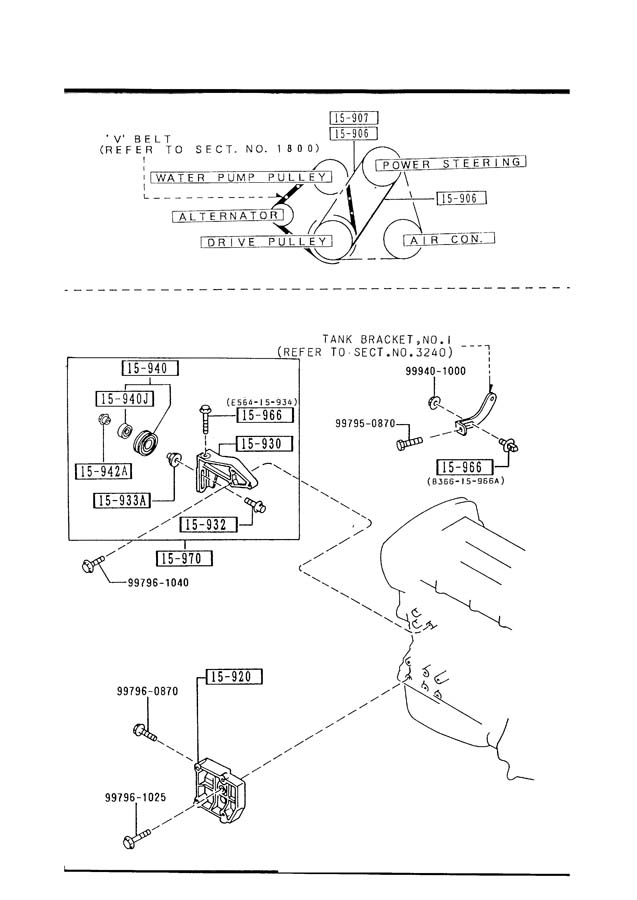

    If everything goes well, I will then look at how I can run the A/C compressor after deleting the P/S and swapping to manual rack. Wanted to jot down some things.
    The A/C tensioner bracket for Non-P/S optioned BGs was:
    Part#: BP01-15-951. This is just for the bracket..
    *Anyone know what the hell 15-920 is used for?

    The miata guys like to say the part call out is:
    Part#: BP01-15-930. This actually is the whole assembly, collar, idler pulley, AND bracket.
    Obviously, like most non-P/S specific parts they are discontinued.
    Then the Miata guys thought they were crafty because they pulled a Sephia call-out from the dealer:
    Part#: 0K201-15-930. Then, I'm sure 105 crap NAs later, they depleted stock.
    So now they either use a zombie P/S pump for the wheel, or,
    they just throw on a small Dayco belt and shim the A/C comp bolts if needed.
    Part#: 4PK0775 or 5040305.
    Unless anyone else knows a trick.
    *Should BP Escort/Tracer/Lazer etc. FF cars have interchange?

    15-920 is the mounting bracket for the AC compressor.
    Even if you remove the AC system the bolt on the front side of the engine has to be engaged as it by passes an oil port(stupidest design ever).
    Also any BP motor FORD/Mazda/Kia should work. That being said Ford's numbers should be depleted too. I'd look to see if AUS would still have one is stock, of see if Central America or South Africa still ran BP series. I know they kept making the BF chassics so there is a chance they kept making motors in the B-series family.
    Something else someone should look at, is if an early Z-series found in the protege would work? It seems that it was just an updated B6 style motor.

        The Mazda/Kia bracket and associated Parts you seek are NLA. I do happen to know somebody that’s working on reproducing the bracket and hardware though.

                Yes it will be aluminum. The modeling is done and it just needs to get quoted.
