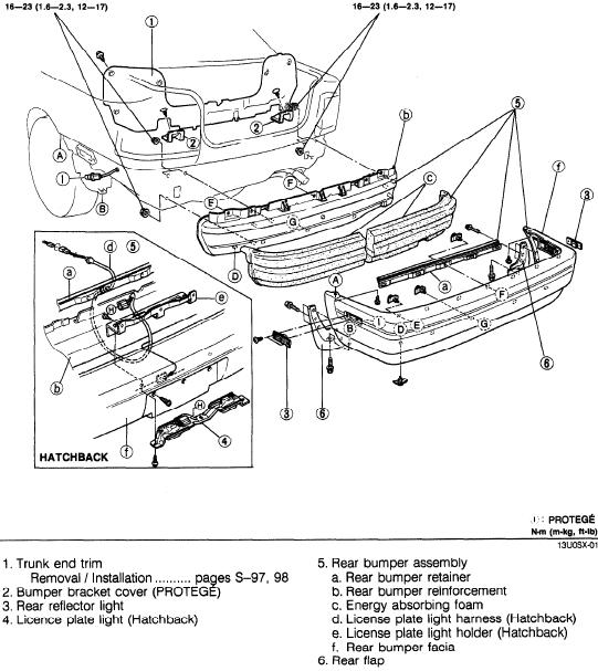

    I just removed the screws under the bumper, and in the fenders, but it still won't comes off? is there some screws on the trunk or something?

                  NOW WITH SPINNER HUB CAPS
                    where did you find this picture?
                    have anything like that for other parts of the car like
                    dash or wiring harnes in the car etc.
                    Is that from some type of manual? If yes where can I found it?
