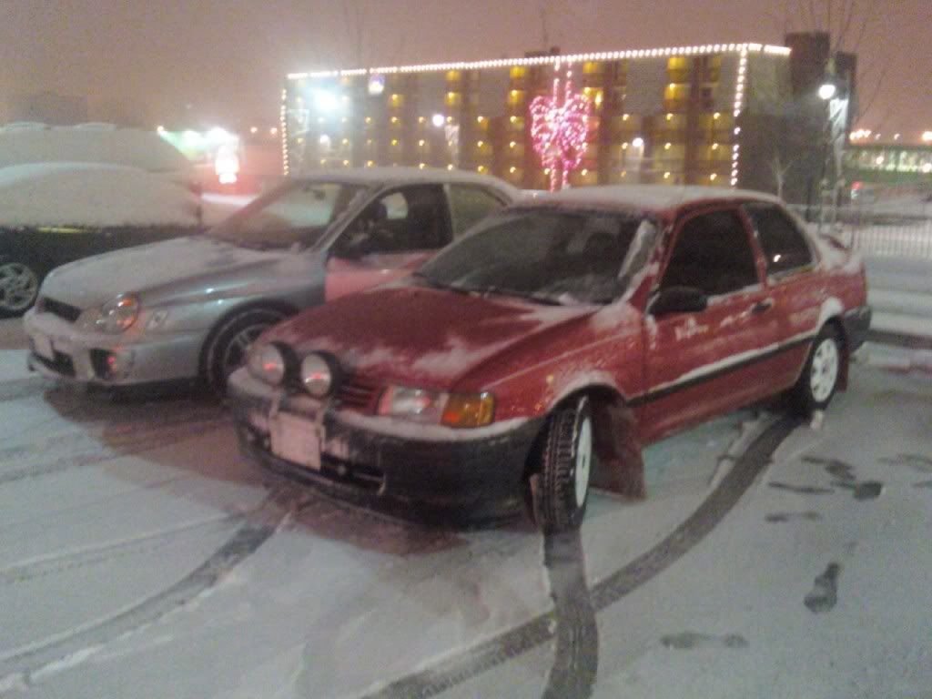

            Thanks for the input Sarge. I have 2 cibie oscAr + on my tercel right now and they are on a flat alum bar made bracket that zig zags through the front grill and is anchored to the rad support with two bolts, and attaches to the license plate mount holes in the bumper . The 4 across idea I think is best for the reason of road debris, these lamps are too much $$ to replace. I would love to do a hid conversion on them but not sure how I would, these seem impossible to retrofit.
