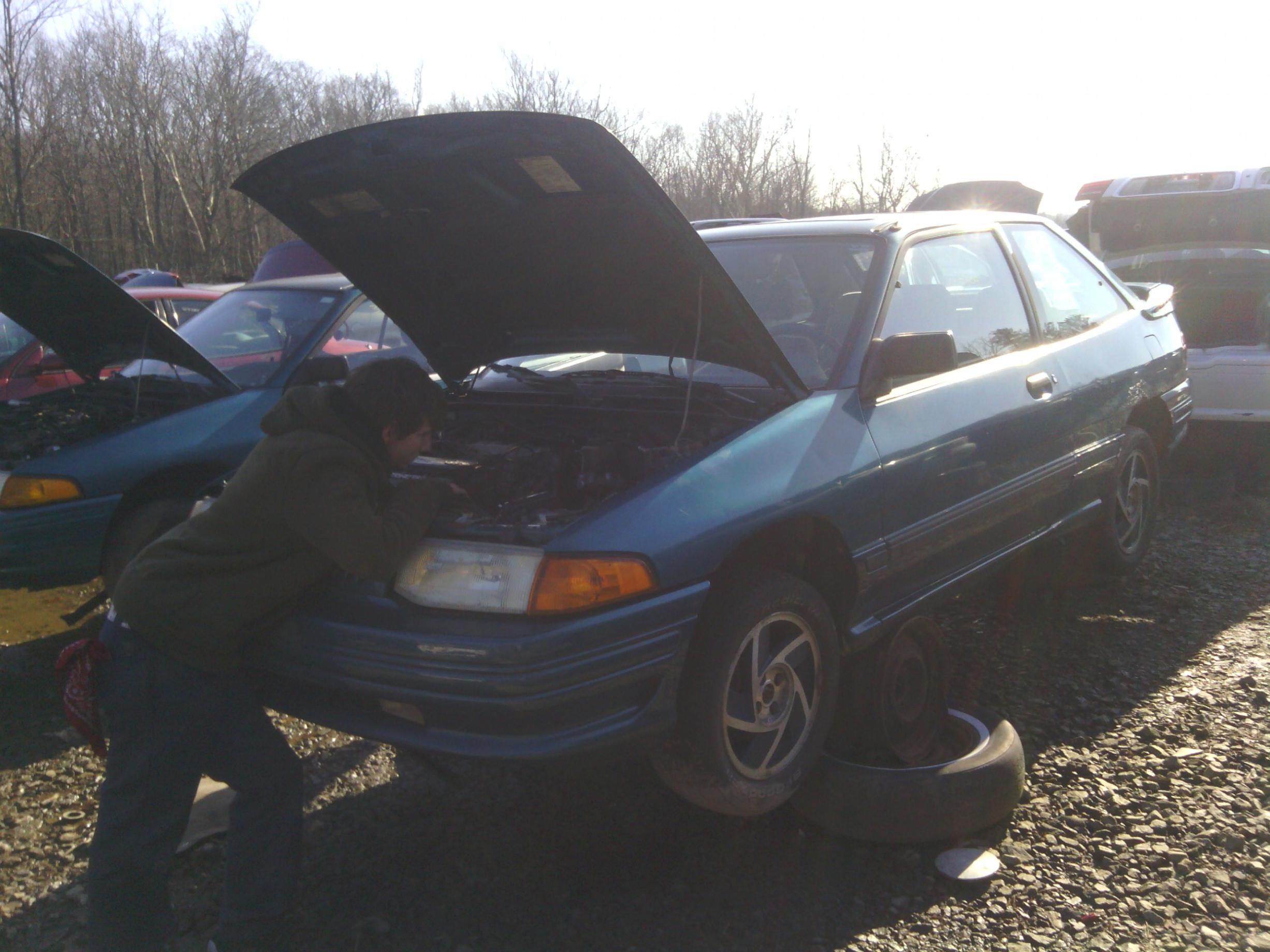

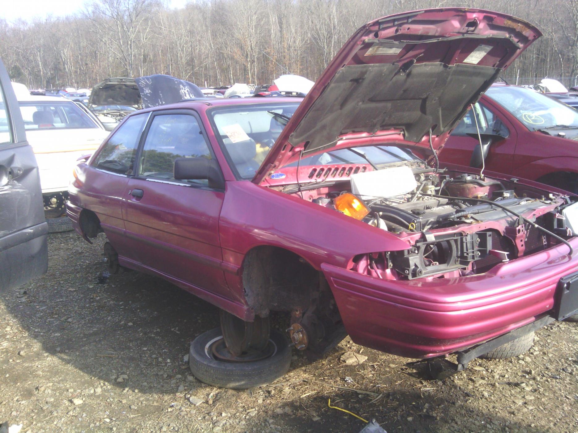

                        More "sportyer" escort GT, the conventional one that we all know and love.

                        And here we have his ugly cousin, you can see the escort gt front grill and the bp05 snug as a bug. There is pink spral gt rims on the other side (can't see them), Full gt interior in red trim, escort gt badges... my guess its a escort gt lol.
                        I know im like wtf aswell never saw one like this. but the interior is identical.
