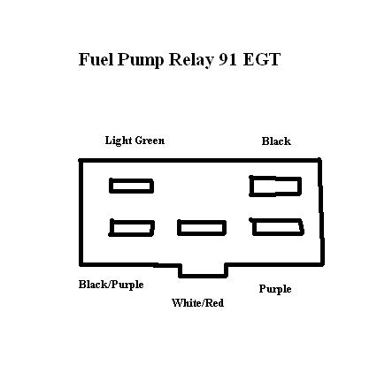

        I don't have an actual picture, but with some mad paint skills, here is a diagram of what the wiring colors are at the Fuel pump relay
        and on the relay itself, the P/N is 056700-6381 DENSO 12V Made in Japan

          well i took the relay apart, and from the diagram above, i put the positive and negative jumpers from the 12V battery to the BLACK and PURPLE slots and the curcuit 'clicked' closed... so my relay is good..
          still don't know about the differences in the wire colors from the manual..
          ejp2fast
          1991 Ford Festiva 5spd (1991 Escort GT BP engine donor, G5M-R trans)
            anyone knows the pinout for this denso relay?
