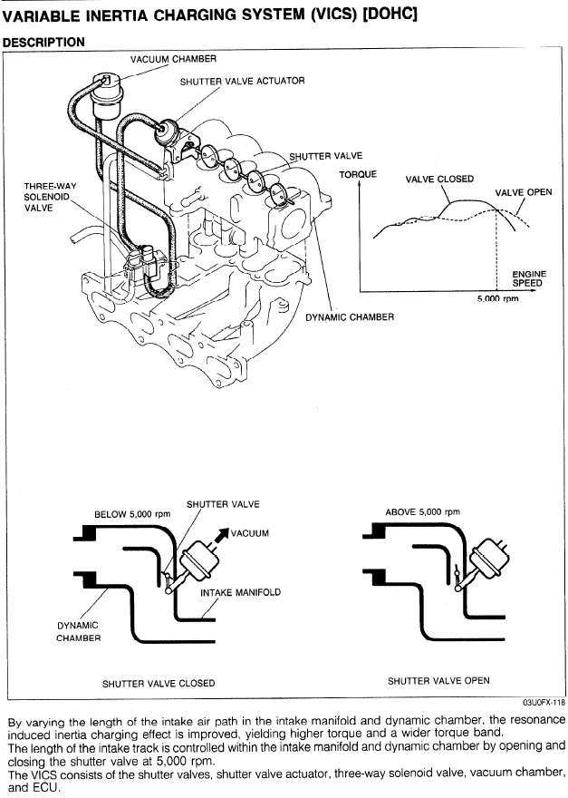

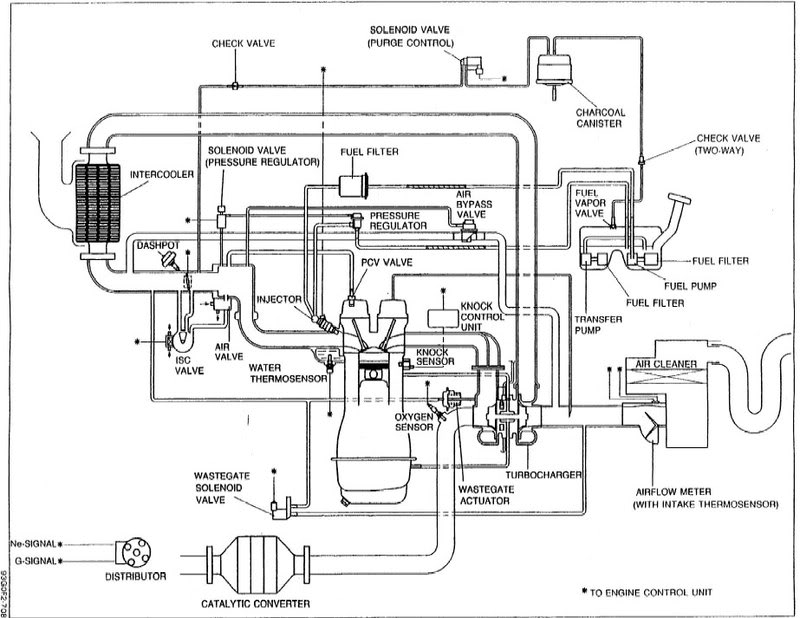

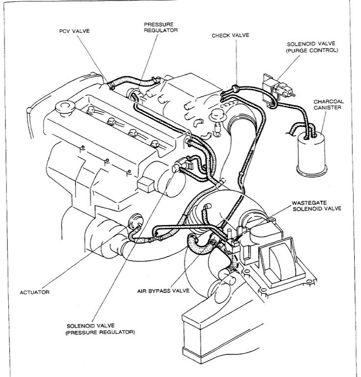

Yep, vics & fpr are side by side on the intake runner. Definitely hook up the PCV and don't forget the brake booster line, which requires a check valve so boost does not enter the booster. Then of course, your MAP sensor for MS
edit: here's some diagrams I found in the Forced Induction section
ignore where the FPR solenoid is mounted, that's how it setup for the factory for the GTX. Still shows the vac hook up though.
