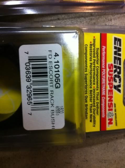

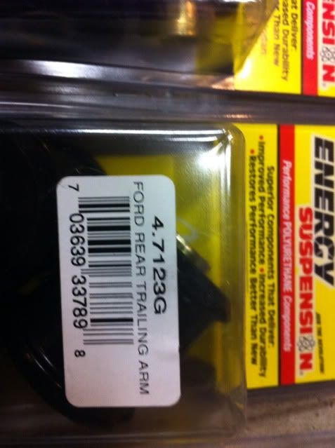

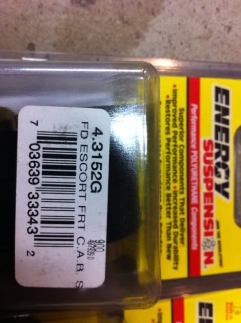

Here's what I have, I know the racks are different, so really it's just the front lca's and trailing arms. I think I'll just install them, regardless of compatibility with the mx3.

steering rack bushings.......... trash em/sell em to a zx2 owner
the front LCA bushings..... front fits the rear is a small bracket. so you might have to use the protege/323 rear bushing bracket
trailing arm bushings will work---Has ClubProtege helped you in someway? show your support by Contributing--- Click Here---

those rack bushings will fit any 2nd/3rd gen escort.
