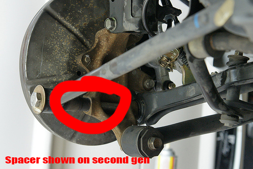

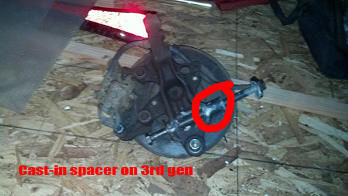

                              Wait, scratch that. I just looked up the how to, and the discs require a spacer where the lateral link bolts to the spindle. Not a wheel spacer. And from the looks of it, the spindles from the s/r and other third gen escorts don't need the spacer, as the spindles are cast wider there, so I'm guessing the spindles won't even work on a second gen without some machining.
                              pics of difference: Click image for larger version
ID:	1234723Click image for larger version
