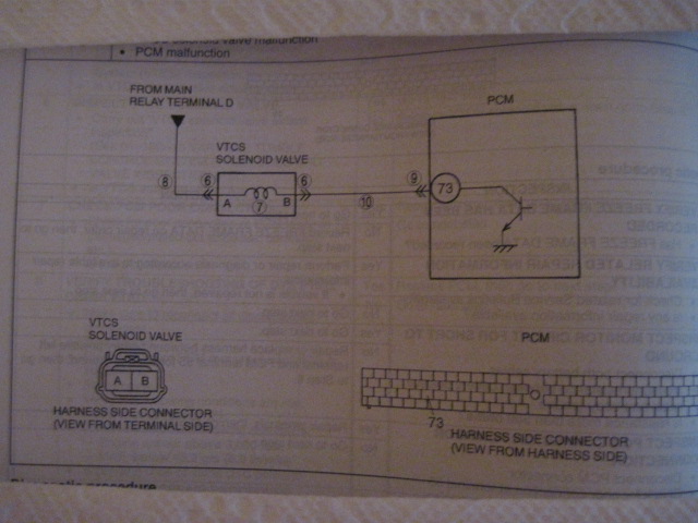

    So I just ran my OBD2 scanner on it and came up with a p0421 (warm up catalyst efficiency below threshold) a P0300, and a P0301 (random misfire, and on cyl 1) Also a P1569 (VTCS solenoid valve circuit low input)
    The 0421 I believe could be fixed with a header and exhaust with a new cat or test pipe. Or just the plug fouler mod. The misfire codes I believe maybe the coils need replaced because I have done plugs and the goofy little wires from the two coils. Now the 1569 is what I am unsure of. If anyone has advice on that and suggestions based on other knowledge of these cars for the other 3 codes I would appreciate it.
    I did just pull the green plug off of the intake mani, and the connector for the red wire is very corroded. Hopefully cleaning this up will fix that 1569 code. the biggest issues really are how rough it runs from the misfires.
      P1569: Variable Tumble Control System (VTCS) Solenoid Valve Circuit Low Input
      According to the FSM, the possible causes are:
      Poor connection of connectors at PCM and/or VTCS solenoid valve
      Short to ground in wiring between VTCS solenoid valve terminal B And PCM terminal 73
      Open circuit in wiring between main relay terminal D and VTCS solenoid valve terminal A
      Open circuit in wiring between VTCS solenoid valve terminal B and PCM terminal 73
      VTCS solenoid valve malfunction
      PCM malfunction

        From what I have read it seems you can just disable this entirely. It may be worth it to just clean the connections up and wire a new ground. Isthere any way to test the coils on this motor?
