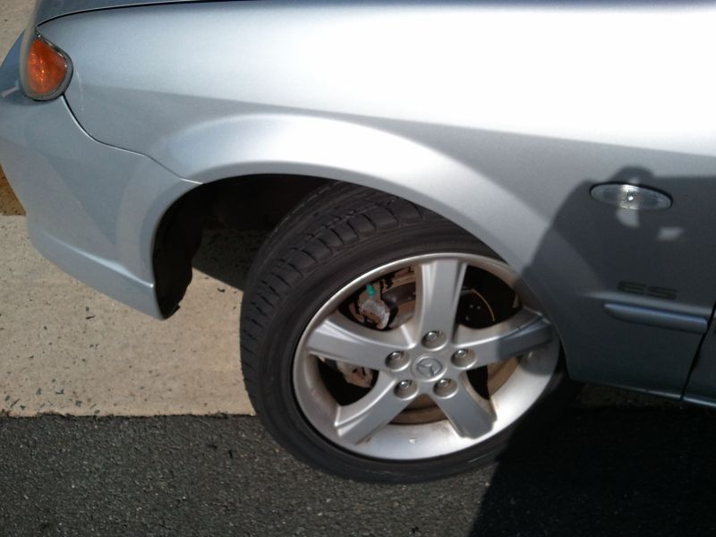

the cause: deep pothole. dented the wheel pretty badly. drove around for a week with bad alignment while the replacement wheel and bushings were being shipped.

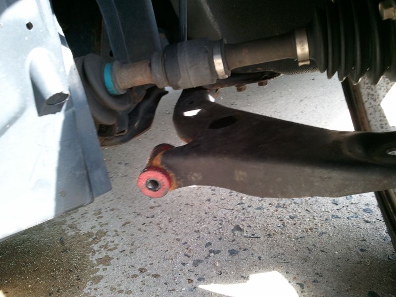

here's whats been done: lower control arm torn bushings replaced with pedders polyurethane bushings. dented wheel replaced, remounted old tire. 4 wheel alignment.
here are the initial symptoms: after the install, when the steering wheel is straight the car goes toward the right, straight line to the curb if i let it. i have to keep the wheel pointed to the left to stay straight. after 1/8-1/4mile (a guess) of driving with the streering wheel pointed to the left the front end will get loose and feels like i'm hydroplaning on dry surface. the steering wheel wobbles a bit and i have to correct it. this happens on the highway and around town.
today:
the shop swapped front wheels from left to right. the mechanic who test drove it said that the car pulls to the left now. which indicates bad tire since it was pulling to the right. i took it on the highway and found i did not experience pull, but now had severe torque steer when i did not have it before.
1. whenever i accelerated the steering wheel will turn to the left.
2. when i let go of the pedal the steering wheel will correct itself.
3. if i keep the steering wheel straight and i accelerate, the car will definitely pull to the right again.
i had to go to work but i will call the mechanic again and let them know of the new symptoms. is this a sign of bad tires or bad alignment? are the pedders bushings the cause? i read in this forum that poly bushings would cure torque steer, not induce it. any thoughts are appreciated
