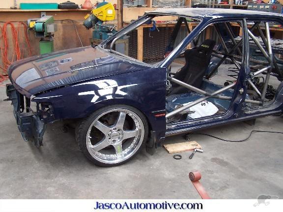

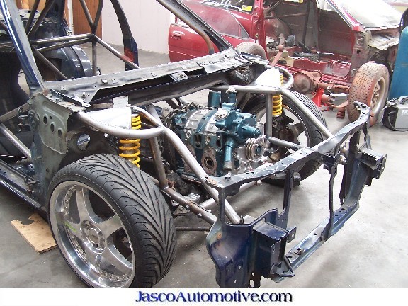

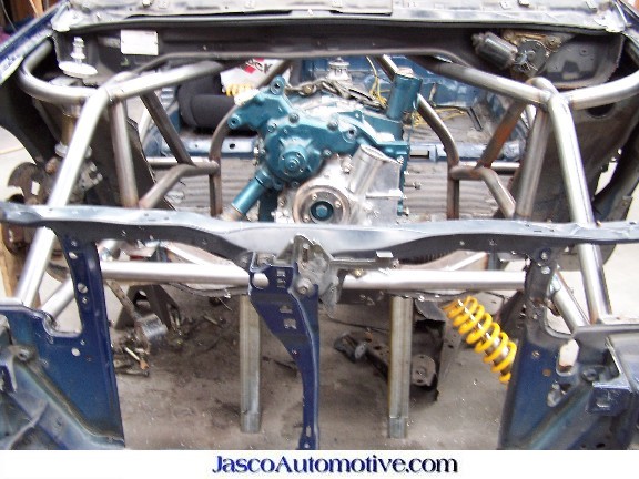

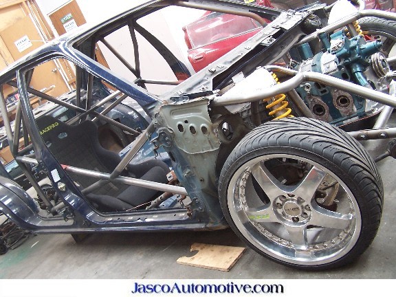

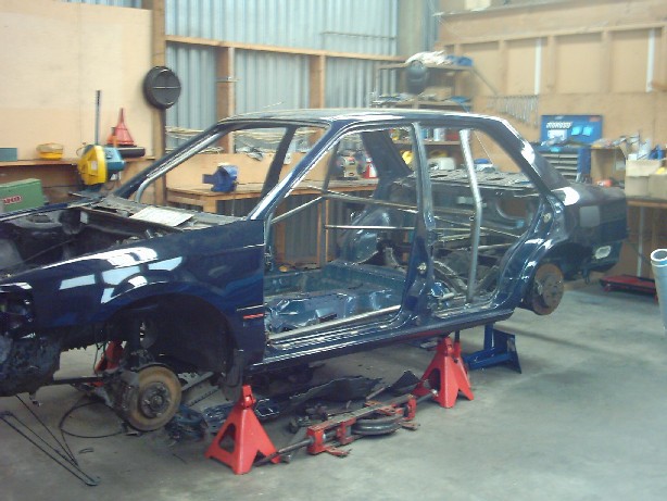

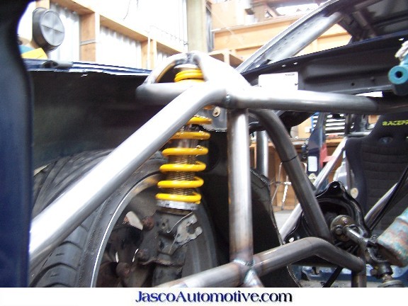

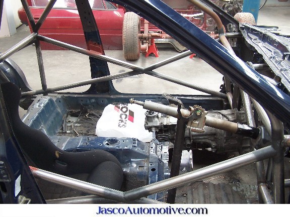

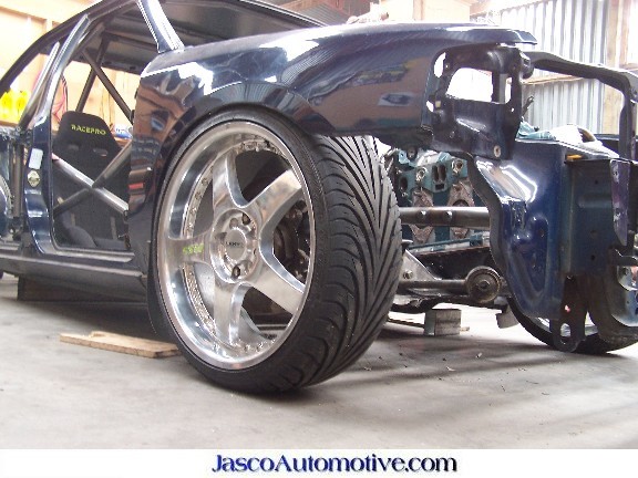

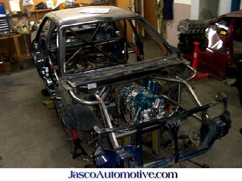

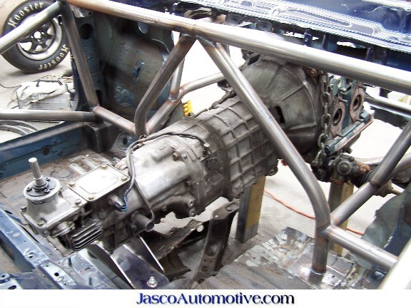

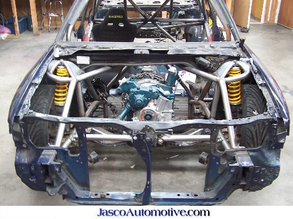

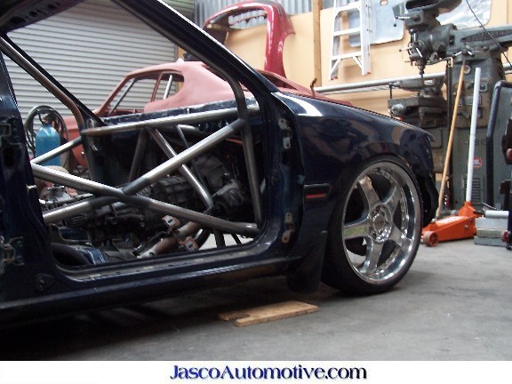

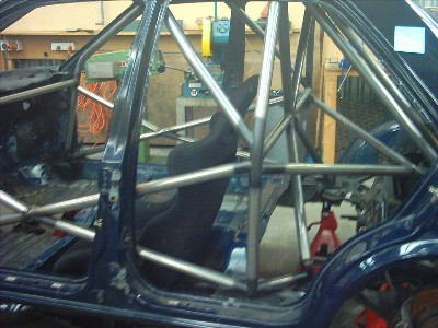

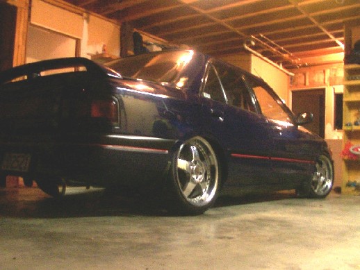

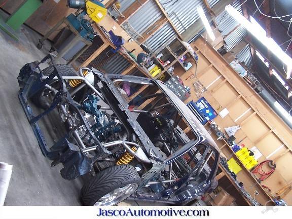

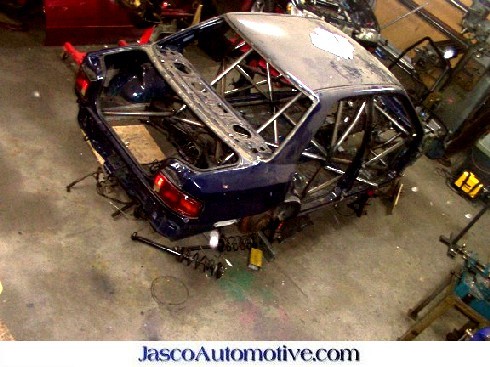

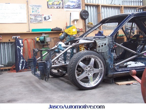

    Holy crap this makes me wish that I lived in New Zealand. This car is forsale i dont think its completed but who cares look at the tubular chassis.
    *1990 mazda gtx sedan
    Contact: 0212233451 for more about the car!
    *originaly 4 wheel drive turbo
    *space frame roll cage
    *full tube front end
    *nissan 200sx cross member

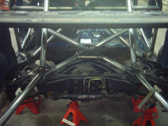

    *r32 skyline godzila rear end
    *front adjustable suspention
    *no wheels
    *no motor but comes with series 6 rx7
    gear box
    *setup for 20b or 13b rotary
    *$8000 grand spent on cage alone

            very nice find!!!!!!!!!! i can tell he just could not finish this project.this thing would cost a small fortune to finish. very sad i did not become a reality for thees guy.so close but so far way.

                I wonder what the balance would be like.

                  How the hell did they expect that to work. The nissan hicas is confusing as hell to wire up/get to work stock. But lets make it even harder by throwing a rotary into the mix.
                  Should of just stripped an r32 and welded all the pieces parts to it. Including all the stock wiring.

                      rear steering...
                      why?
                        To take corners faster DUH
                          Hes probabay not going to hook up the hicas casue he would need to run two pressure lines from the PS pump plus wire up the hicas sensors. On our Nissan Ceferio A31 it had hicas but we capped the lines and adjusted the alignment so it rolls down the road in a straight line.

                            then he should of just used a 300zx rear end.
                            Its even lighter than the 240sx rear end too.
