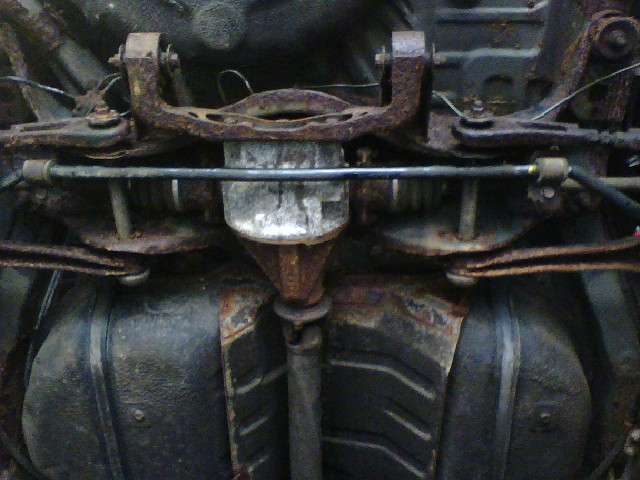

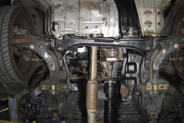

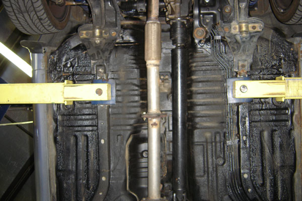

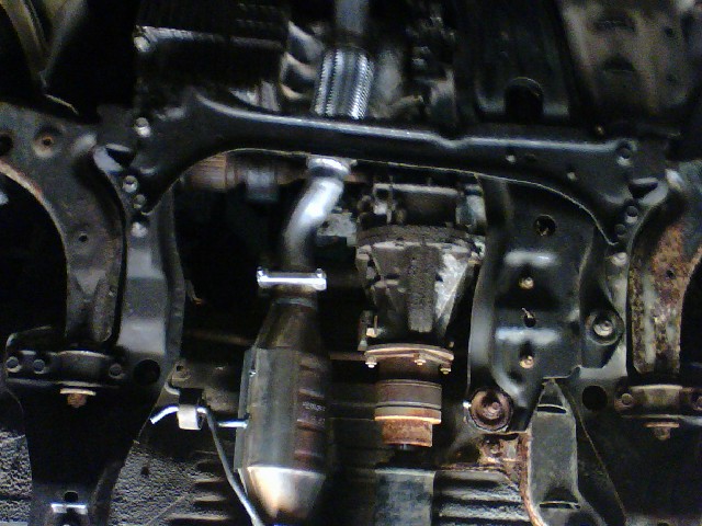

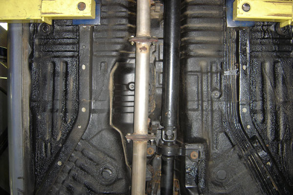

Here's what i have to contribute, from when my exhaust was installed. I forgot my real camera so they are crappy cameraphone pics
you can note that there is no front subframe, just a bracket that each LCA bolts to and a thin brace between them at the bottom. the floor pan is 100% different from front to rear, with different mounting points in the back for the subframe and a different tunnel with brackets for driveshaft carrier bearings.
