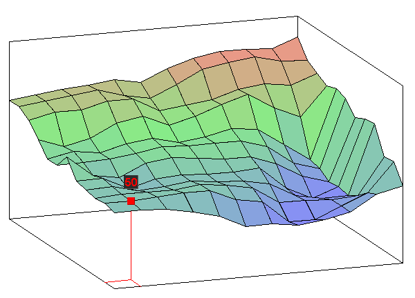

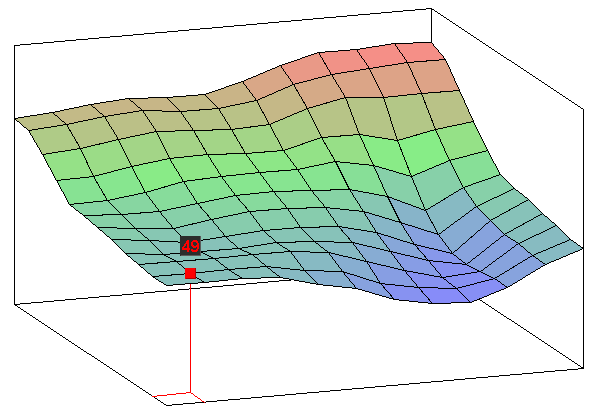

since i noticed most every tune ive looked at from people on here , no one seems to know how or just in general doesnt smooth thier tables after tuning, or no one uses the 3d table view to know how all over the place it really is...... i hate the spikes and mismatched values, ive smoothed mine for a while now, but now theres something easier . Travisb on miataturbo made a spreadsheet in accel to do it for you now. it interpolates in a different manner than what phil, ken and james have written in to the tunerstudio software at this time. meaning if you interpolate your table in tunerstudio it wont average all the cells, itll mainly just flaten out the whole table..... heres a link to whats been discussed so far, along with some pics to show what im talking about...i noticed a few people tried this on thier spark and afr tables too. if your running around with a table thats all funky looking try this out, it should make driveability alot better for you.... this will work with megasquirt, adaptronic and anything else with a 12x12 or 16x16 table, or if you want to make a larger speadsheet you can do what ever you want...
heres one example of what it does, this is the 12x12 speadsheet for reference. but ill post the 16x16 and the one with smoothing factors too if anyone wants to try these.
bad
good
bad
good
