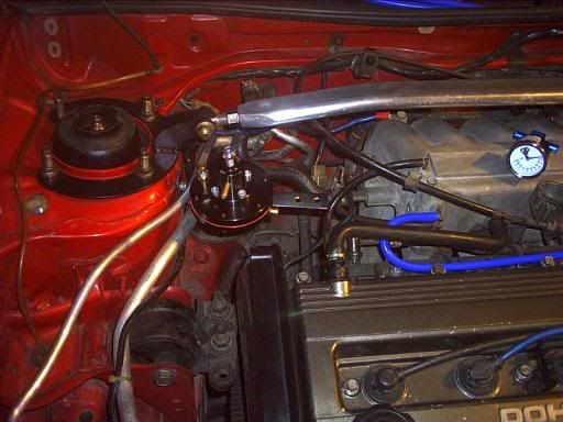

    Got this FMU today it's a SPA TURBO 6:1. I can adjust the fuel pressure also, the guy told me it was a new brand. I'm going to install it tomorrow and a fuel pressure gauge.

            I got the BEGI one myslef and will be installing it ove the weekend. Does anyone know where the best place to install the fuel pressure gauge is? It has to be seeing the same pressure as what the injectors are getting, right?
              I installed mine on the return line.
                That would be before or after an aftermarket fpr?
                  Before. It's between the RRFPR and the rail's return line outlet.

                    What would be the best ratio FMU(i.e 12:1, 10:1, 6:1) to get for a gtx with a walbro 255 at about 10 psi?? also whats the prefered brand?
                      With that setup I have a 3:1 ratio. Beyond that you will running very rich.
