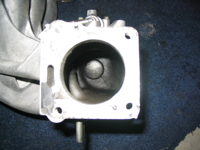

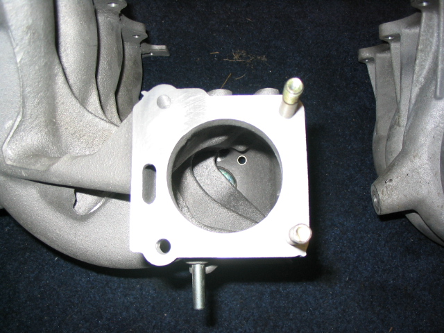

    the difference mainly is the internal workings of the plenum. there are a no real other small differences that are going to make or break hp/trq gains/losses. this is 100% an internal difference only.
    pic #1 you will see is the gtx intake plenum. its just your basic chamber.
    pic #2 you will see is the gtr intake plenum. now note the "waves" internally. this is what makes it so much nicer. it equals the flow and causes less turbulance.
    both pics you will notice they have the t/b water jacket. the t/b inlet is the same flange and same bore. tho the part number between the gtx t/b and gtr t/b is different there is no difference in it. they are both 4 wire tps t/b's.

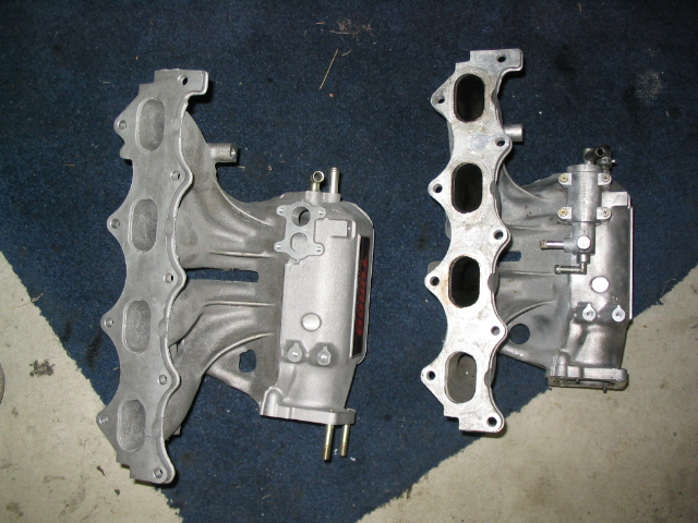

    pic #3 you will see the head flanges. once again no difference. the runners are the same bore. some people have said that the runners are tuned. well from all i can see the only difference is the plenum end of them is tuned. so if that is what they mean by tuned then ok. but some people have said the whole runner is different. i don't have a fiber optic camera eye but the runner and the rest looks to be 100% the same as the gtx.

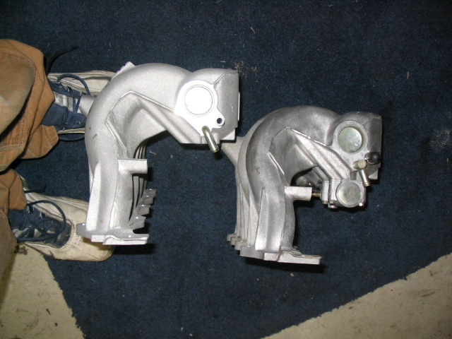

    pic #4 here you can see what is the passenger or left side. the plenum is the same size externally. all your vac lines are the same size also. once again nothing really changed externally.

    Awesome pics! I always thought the runners were different as well. I'll sticky this for some time

      looks great. I was always curious on the actualy performance benfits of it. It probably benefits more at higher airflow volumes.
      Some of the aussie guys installed the GTR manifold on a GTX car and said he felt no difference. Any idea about this Neuman since you have both manifolds?
        I've heard that it's better flowing but I highly doubt it'll make a noticable difference while driving.

              If you notice in Pic #4 the PCV hookups are different also. I havn't been able to study many Manifolds, but Corksports GTR manifold has the same Rounded L as Neumans. And all the GTX ones I have seen have the T type.

                The longer runners make me think that the GTR is made more for top end like you said.

                  that tee style nipple is no biggy just a different part. there is nothing internal about it that i can see. as in there is no check valve or something like it.
                  the runners on both intakes are the same length. the only reason they look a little different is due to camera angle.
                  i have not run a gtr on a motor yet. but a buddy of mine has. he noticed no true difference. he also has an n/a head. he raced his cousin who has the same set-up just gtx stock stuff and the cars ran the same 1/4 times. they had 4 or 5 head to head runs at PIR in portland oregon.
                    I put a gtr manifold on my bpt gtx. I had to turn my boost controller down by a few psi after the swap. Lag was cut by some amount as well. I have a NA protege head installed, as wide open an intake tract as can be had without getting rid of the AFM, a freaking huge IC, and a very wide open exhaust. i know Greg D. didn't see much difference with his install, but this is what I got out of it. --Jay

                      Ya but have you seen any L shaped ones on GTX manifolds??

                        bugs look at pic #4 you can see the nipple you speak of perfectly. its only design difference not function. also that is just a breather tube anyways for blow by.

                            bugs and i chatted on AIM lastnite. my gtr is new from mazda in 2004. the gtr intake manifold on the CS protege is a stock one from 90-94 what ever year it was built. it has the tee style pcv line like the gtx pictured above. we came to the conclussion that its just and updated design from the original stock units.
