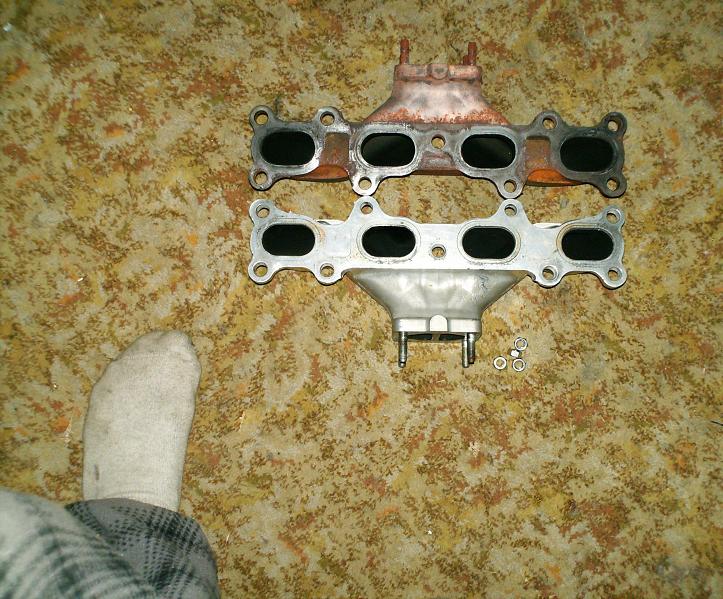

thats clean did you do the manifold also
External wastegate on your GTX manifold

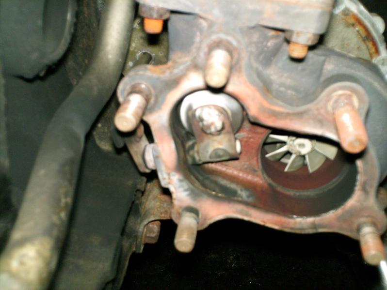

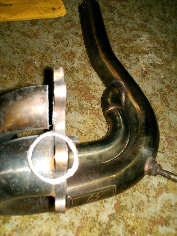

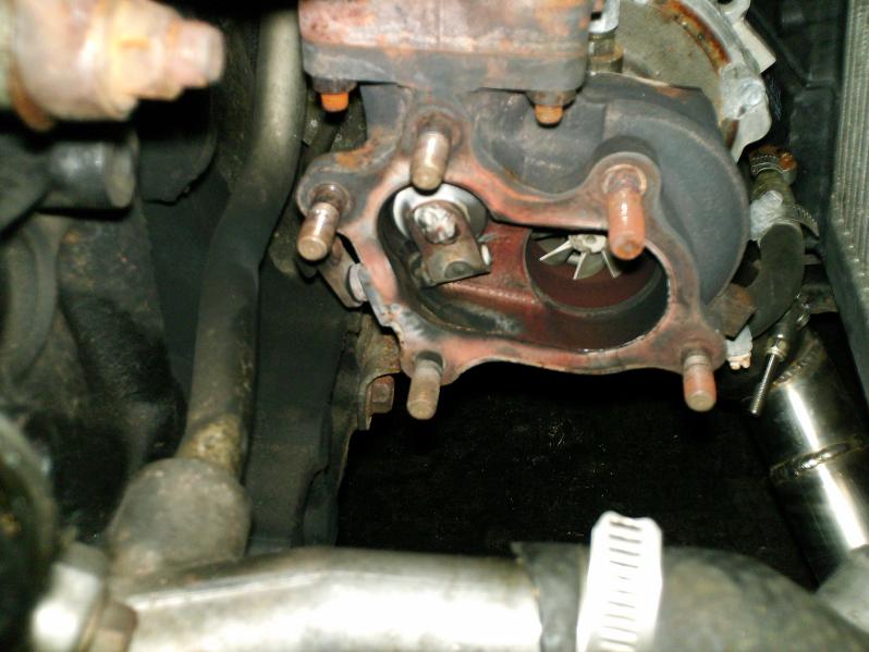

just hold the flapper door closed tight with a clamp and put some tack welds on the shaft. looks purtyEscort GTR -- 11.87 @ 117.6 mph -- 320 HP / 325 Ft. Lbs. @ 23 PSI
fully welded ftw
the manifold is a coated piece.---Has ClubProtege helped you in someway? show your support by Contributing--- Click Here---
I pet my dash when I get into the car..."good car"he actually has a mazda tree, parts grow on it
i suppose, as long as you know someone with the mad skillz to weld cast...Escort GTR -- 11.87 @ 117.6 mph -- 320 HP / 325 Ft. Lbs. @ 23 PSI
i just don't trust a simply tack weld to hold the flapper door tight enough for my liking---Has ClubProtege helped you in someway? show your support by Contributing--- Click Here---
not just a tack, you could throw a solid bead down on the end of the actuator where it comes out of the housingEscort GTR -- 11.87 @ 117.6 mph -- 320 HP / 325 Ft. Lbs. @ 23 PSI

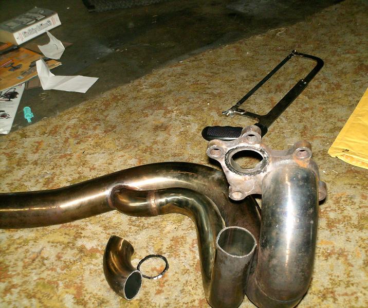

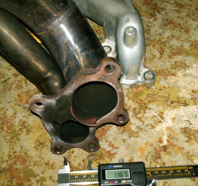

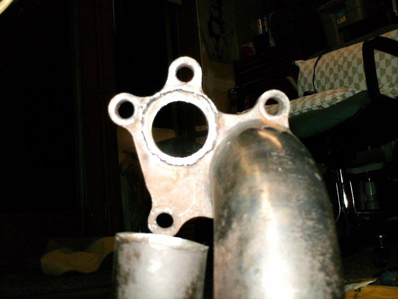

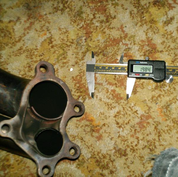

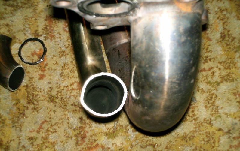

Just ordered a buttweld fitting to go onto the manifold.
Guest
smoke, I've done both. its only going to get more & more cut up as time passes, im going to shorten it some i think. since it was designed on an auto pan its never fit mine right, (its not a big issue tho as i trimmed up my pan, but i may just leave it.

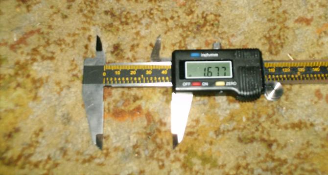

I need to currently figure out which pipe to buy for building into the CS DP---Has ClubProtege helped you in someway? show your support by Contributing--- Click Here---
