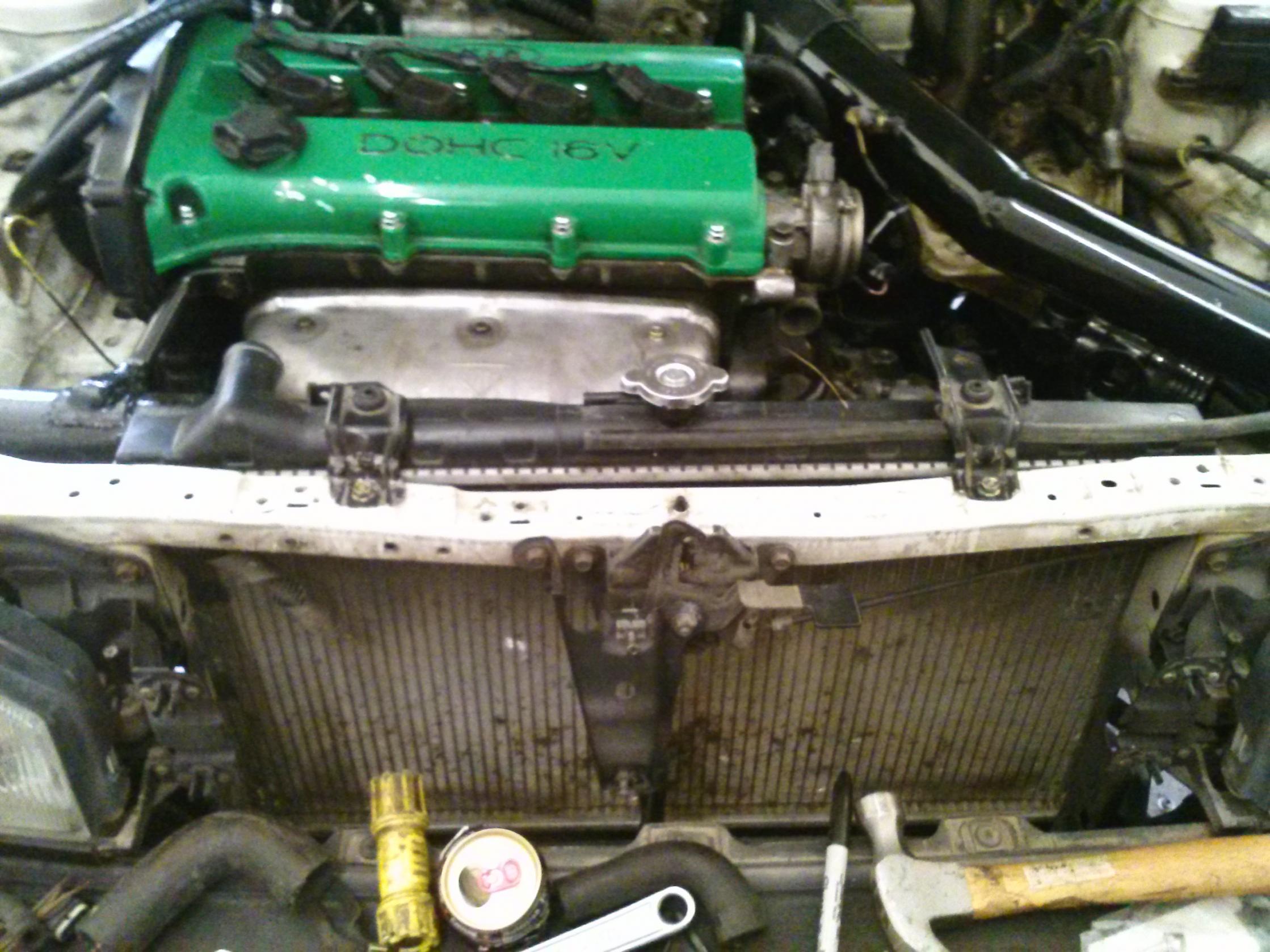

ive been looking for a dual core radiator for my BF for quite some time and it seems like the dont exist(unless you want to have a custom one made for ~$400) my buddy told me to keep searching by the overall dimensions and make a universal one fit. so as i was searching i kept coming across radiators for an S13 so i thought why not. checking my local junk yards i found one and picked it up for $50 to use as mock up until my aluminum one gets here.
the only draw back i see immediately is that the upper radiator hose connection is on the passenger side. i have not made hoses yet but i will post my progress as they are being made.

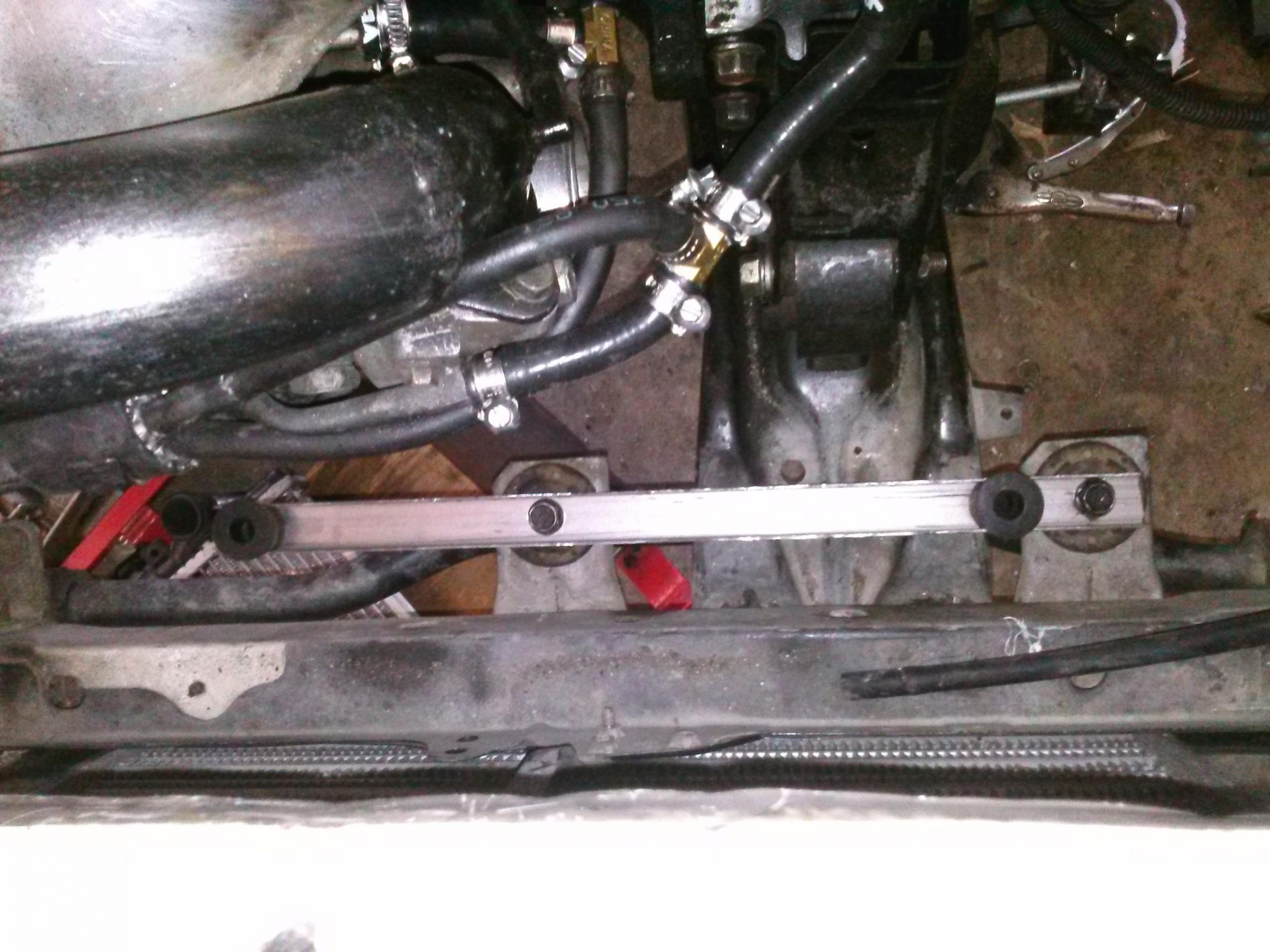

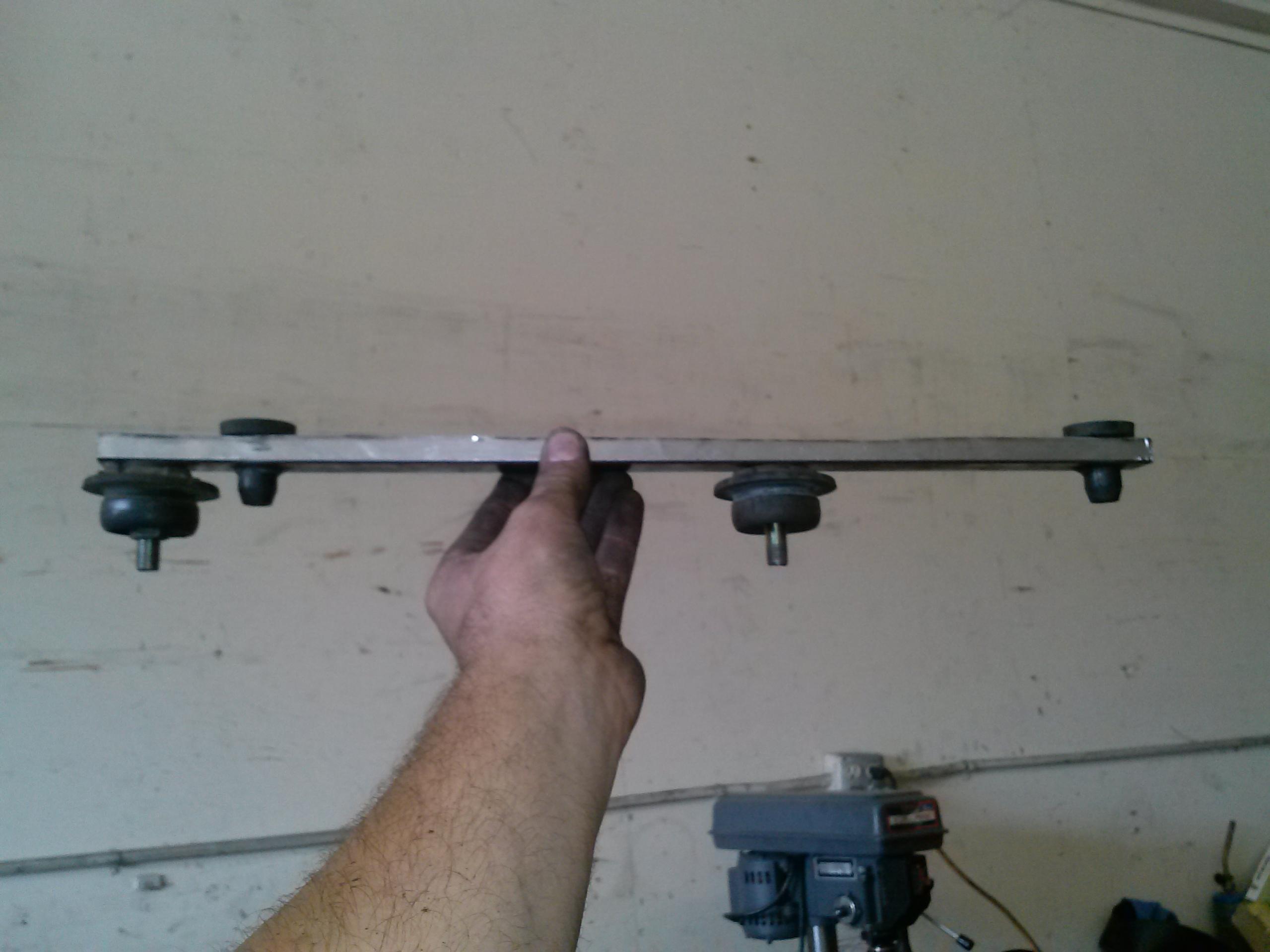

the first order of business was to cut a 1"x1" square tube long ways down the middle to make a 1"x1/2" channel. i marked where the mounting pins were and make holes for the radiator to fit into and put bolts with fuel line around them for the bracket to fit snugly into the stock radiator mounts.

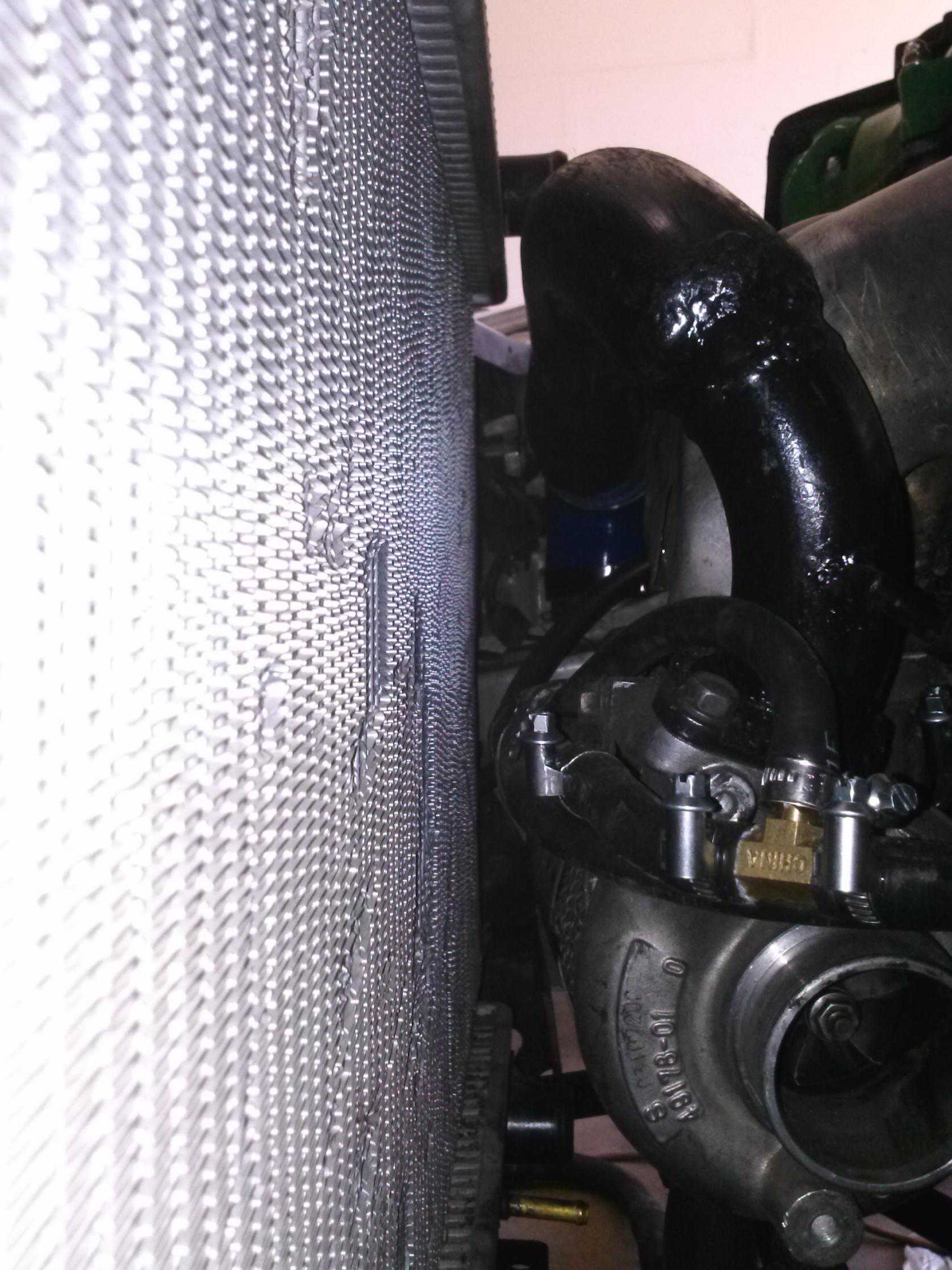

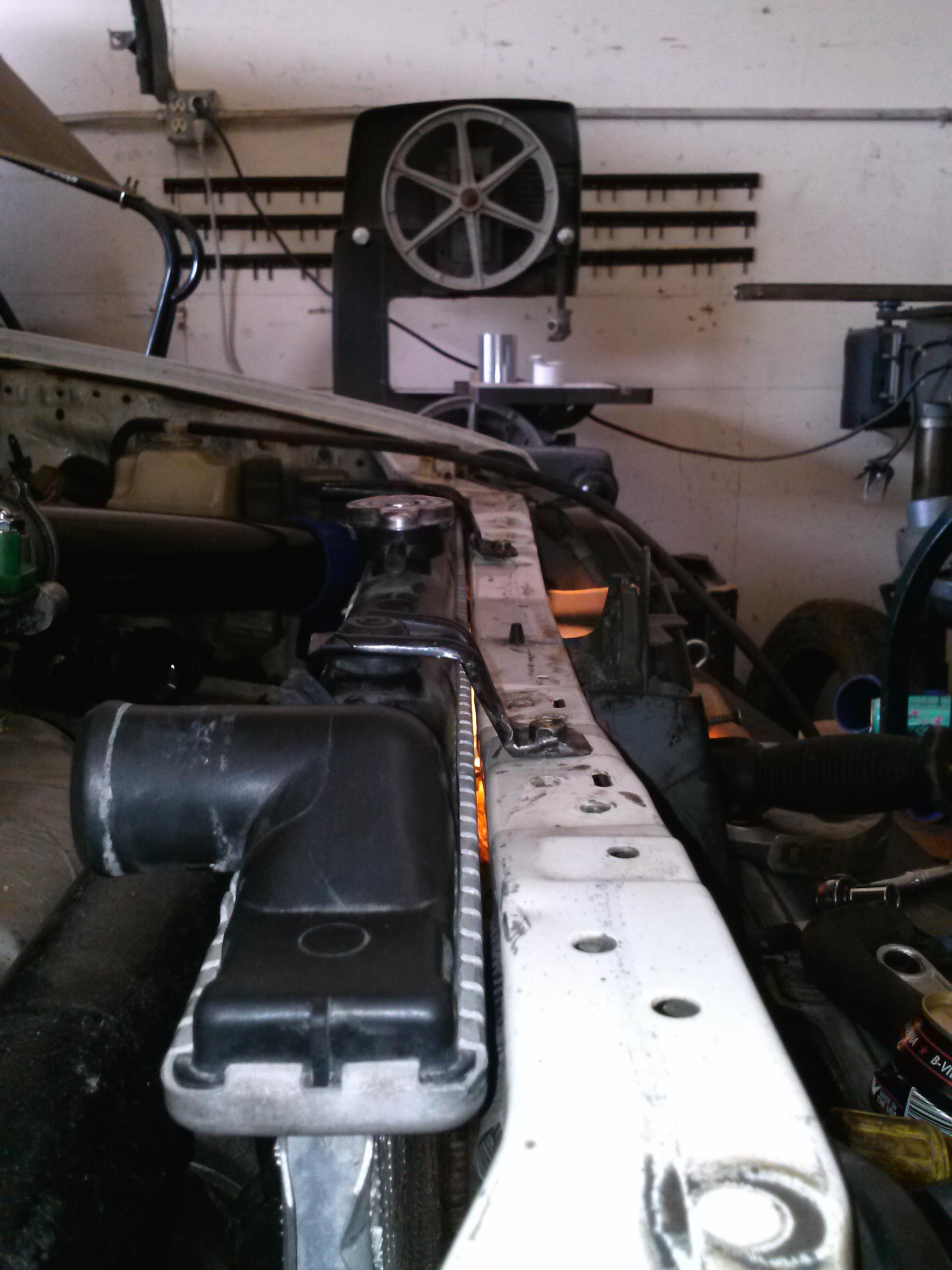

after the lower mounts were made i flattened then re-bent the stock S13 upper mounting tabs to make them about 3/8" longer. they lined right up to the holes in the core support that normally have the plastic clips that hold up the wiring harness. the fitment was a bit too snug so i took the radiator back out and lightly bent the core support with a crescent wrench to give me a little more space up top. i have plenty of room up front for my pusher radiator fans and plenty of clearance from the turbo heat sheild.
