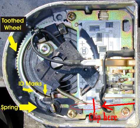

I've read elsewhere that there is a flapper valve in the intake that triggers the relay. Is that a likely fail point? Or would the fuel pressure regulator be more likely? Is there a way to test the fuel pressure on the 323?
