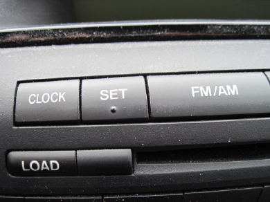

Photo 1. Display control buttons

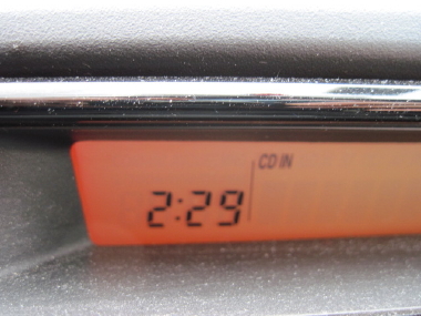

Photo 2. Time display

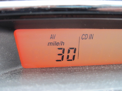

Photo 3. Average vehicle speed in mph display

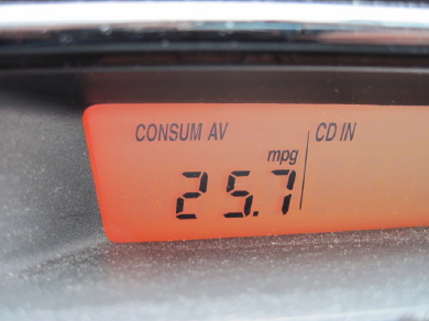

Photo 4. Average fuel economy in mpg display

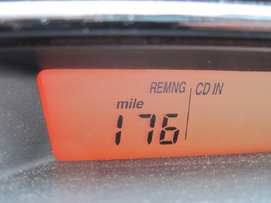

Photo 5. Miles-to-empty display
