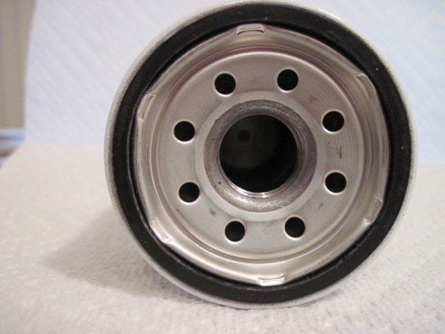

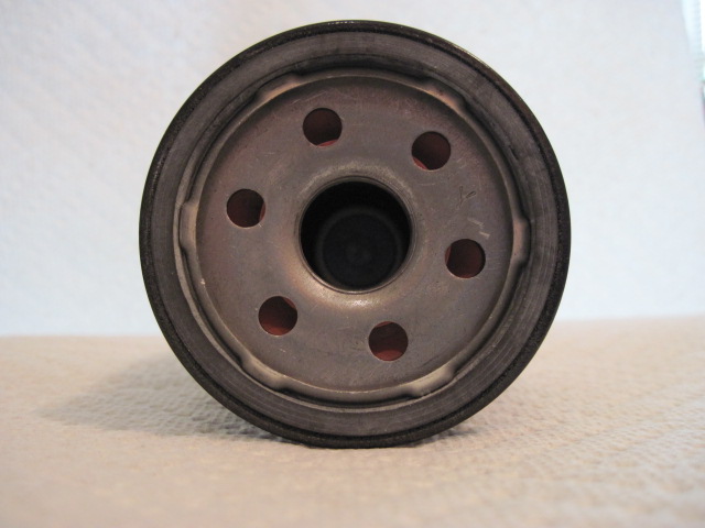

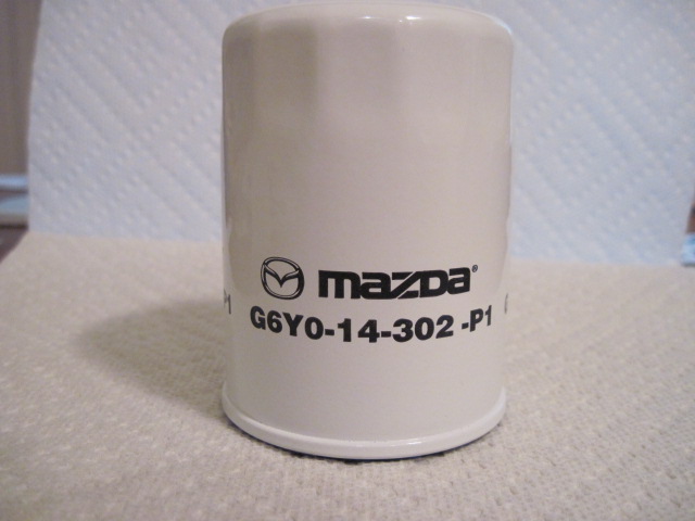

    Appearance-wise, in contrast to the earlier one the new replacement filter is painted white, has a flat instead of a rolled gasket, and the internal sleeve is crimped rather than pressed into the filter body (see photos below). In fact, the more I looked at this new filter, the more it started to look like a rebranded Purolator L14610. I accessed their website, looked at the photo of the 626 V6 filter and compared it with my Mazda filter. Sure enough, they look identical (see the photos below and you be the judge). I may yet go to PEP boys and buy the purolator just to compare the two together. Could P1 in the p/n refer to Purolator? Nah, that's too obvious.

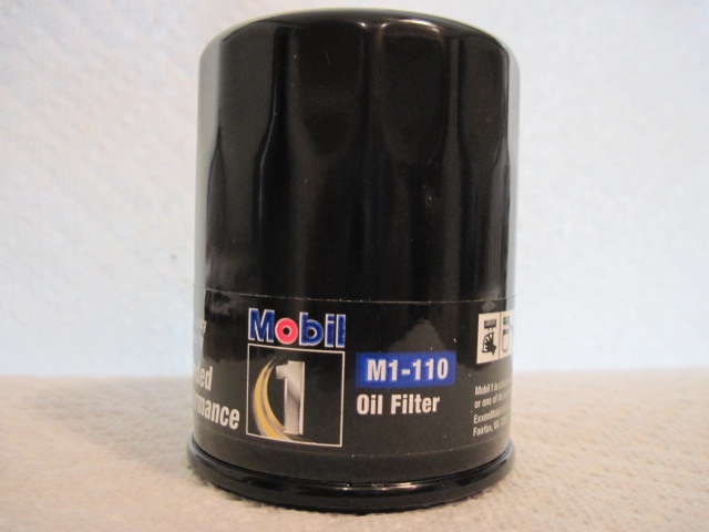

    Based on the study's conclusions, I decided to consider Mobil 1 and K&N filters as possible replacement candidates. I don't like the way Amsoil is marketed and I'm not a fan of RP. I bought Mobil 1 (p/n: M1-110) at my local PEP Boys but they were out of stock on the K&N (p/n: HP-1010). When that's available, I'll line the three up and stare intently at them until the one true filter makes its presence known in my heart. Will he choose Mobil 1, K & N, or OEM? Stay tuned. I have to decide soon because it's time to change my oil. The nectar of the Gods awaits me.

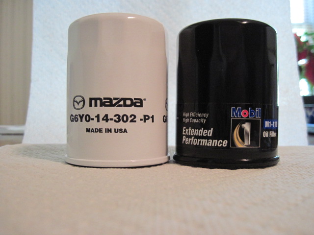

    Mazda G6Y0-14-302-P1: 90 mm x 65 mm (measured)
    K&N HP-1010: 95 mm x 68 mm (published)
    Mobil 1 M1-110: 85 mm x 68 mm (published)

    Photo 1: New Mazda Filter p/n:G6Y0-14-302-P1
    Photo 2: Gasket End of New Mazda Filter

    Photo 4: Mobil 1 Filter p/n: M1-110
    Photo 5: Gasket End of Mobil 1 Filter
    Photo 6: Height Comparison of Mazda and Mobil 1 Filters
