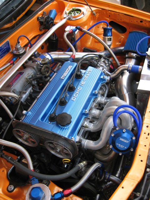

    Just a couple more updates on the 'ol Laser. You would have seen the last pics where I built myself a Forged Engine running the GT2876R. Well its all complete and running with over 300HP at the wheels (Australian spec). Running 22psi at the moment.

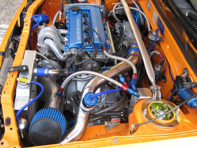

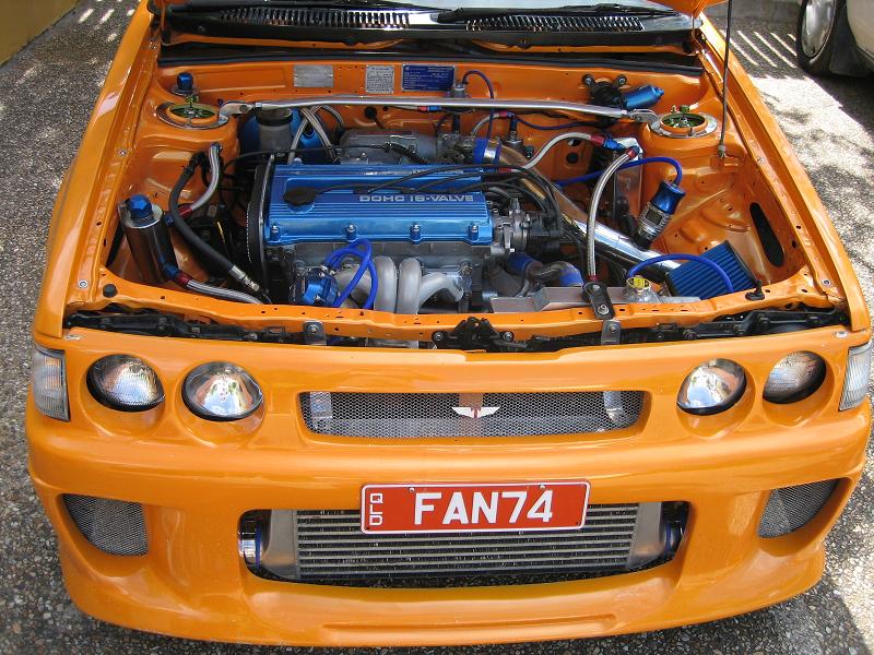

    Attached are all the engine bay shots. Fitted some Coil overs and Black Sparco harnesses as well for the track. Few little things to finish off.

    GT2876R, Turbosmart Ultragate, Weisco Forged Pistons, GTR Conrods, Race Flowed Head, HPC Tube Manifold, GTR Plenum, 550cc RX7 Injectors, Custom Fuel Rail, Infini LSD Diff, Straight Cut PAR 3rd Gear, FMIC, 4" Intake etc.

            I built the engine myself for dirt cheap. It basically has a Race Ported and Flowed Head with Weisco 40 Thou over pistons and GTR COnrods (All new bearings and seals etc.). No cams yet. Also has a GTR Plenum for now.
            Made the Manifold and Raditor from Civic items. I'll probbaly be chanigng the manifold for thicker runners down the track (modify a EVO Manifold).

                does it have the 3" hole under the airfilter like a BFMR? so you can hide the filter in the bumper?

                    There are holes both sides. I had the intercooler come up both sides with my old setup. The Cooler pipe goes through the hole under the filter.
                    Its a Ebay budget alloy radaitor for a CRX/Civic Turbo but it actually does not work too bad. I just modified it a bit.
                    Its running a Microtech LT8s ECU with Dash Unit. And running an AVCR boost controller. All Autometer Ultra-lite gauges.
