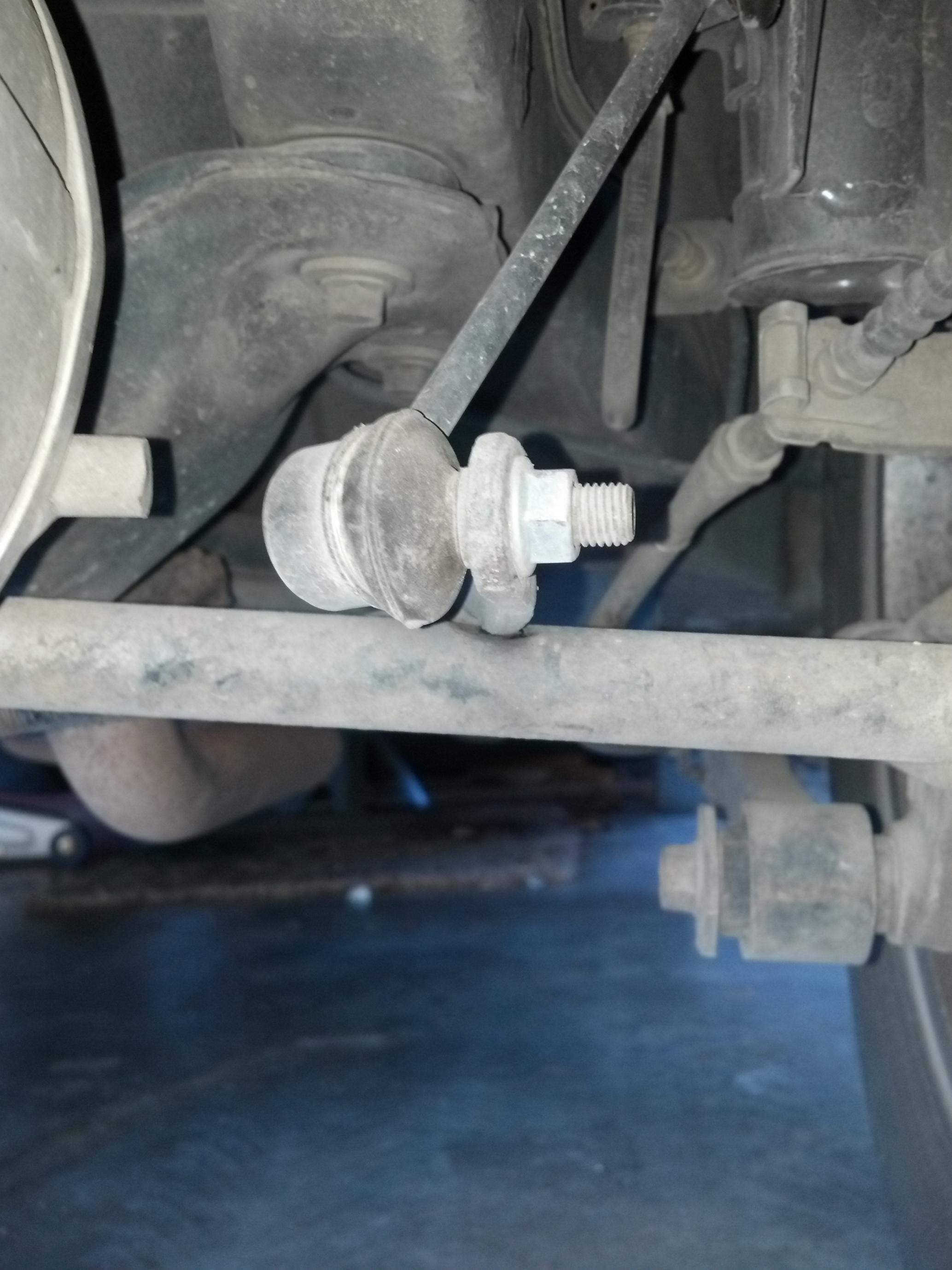

Swaybar touching control arm possibly?
the picture is hard to get a grasp on. could you take a picture showing more of the general area- per say from farther back.

i've seen people call the part your anti-sway bar is touching lateral links, and like 3 other names...
...from one semi-intelligent mans thoughts to yours, i'd describe it as being one of the 4 rods connecting the rear subframe (they bolt into the middle of the rear subframe) to the rear knuckles. This picture looks to be the passenger side of the car.
It definitely looks like you've got the wrong end-links on there, did you just change them? Is your car a protege5 or a sedan? There's different length rear end links for the regular protege sedan, the protege5 (which shares the same suspension with some sedan models equipped with a "sport suspension" option, i believe this shows up as "SSP" on the little vehicle information sticker on the inside of either the driver or passenger door sills) and the mazdaspeed protege.
..unfortunately, i can't remember how long any of the end links are, but i believe mazdaspeed rear endlinks are like 7.5 inches and protege5/sedans with the ssp option are like 6.8 inches.
Measure your end links from the center of one bolt to the other for us, i'm pretty sure you've got the wrong links yo.
Looks like you for some reason have front endlinks on the rear. They're supposed to be a lot shorter. My mom just had that issue with replacing the links on her P5. She ordered a front and rear set but received (and subsequently had installed) 2 sets of fronts. When she told me it was clunking, I immediately knew why without even looking at it. Just buy a new pair for the rear, verifying the length first.Last edited by ThatGreenBG; 01-11-2013, 11:32 PM.Team Fail Motorsports
That's just the nature of the beach.
Originally posted by Josh Chaney View PostLooks like you for some reason have front endlinks on the rear. They're supposed to be a lot shorter. My mom just had that issue with replacing the links on her P5. She ordered a front and rear set but received (and subsequently had installed) 2 sets of fronts. When she told me it was clunking, I immediately knew why without even looking at it. Just buy a new pair for the rear, verifying the length first.
I lowered the car on Tein S-tech springs with some ebay (Stagg) struts, and bought those end links from O'reilly as they were the recommended for my car. You think I just need to buy some shorter ones?
I can't remember the length on the ones I bought, but I'm curious what people with the S-techs or similar are using.

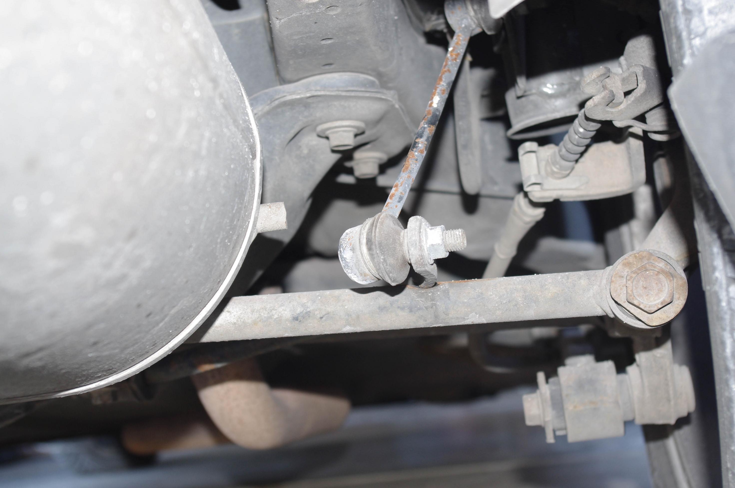

I attached a much better picture of the area.

yes. i would suggest shorter links for sure - that & im not sure your endlink is even mounted properly.
i want to lean towards the outer joint on the outside.

^I would say that could be part of your problem right there. You may need to relocate that bracket because the noise will never go away unless you do.
I've never heard of stagg struts, but I would possibly look at replacing them. I had my 97 protege sitting on some weird ebay struts and even though the owner before me claimed he has "just replaced the struts"....they still made noise. A new set of monroes cured the "clunk".R.I.P. 97 Proto LX> Car killed the deer, but the deer killed the car
108,659 Mi.
2003 Mazda Protégé> 140k miles
I may be tired or not seeing things right, but is the sway bar facing the wrong way? I thought they pointed towards the front of the car, not the back?
Also if you snapped one of the sway bar mount bolts, I'd drill it out and secure it with a nut at the back side, my BG did the same thing but was an easy fix.-Jack
